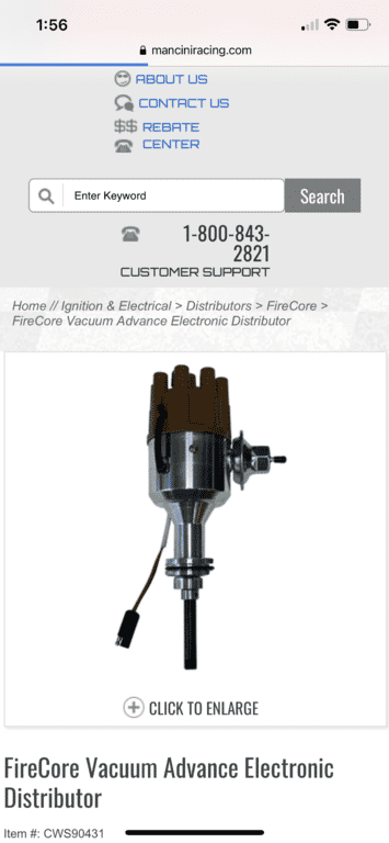

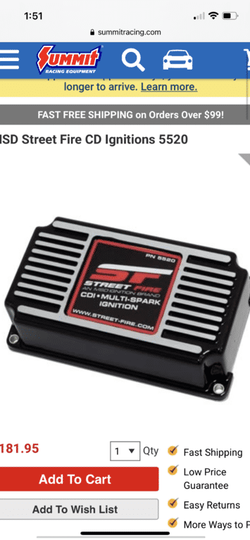

    I was wondering if these will work together!

    Call their tech line. I run the Street Fire on one of my cars. It works great, the engine never started so quickly and it seems to have improved throttle response.

    so the MP upgrade from Mancini a safer way to go parts availability?
