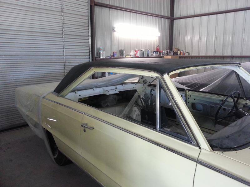

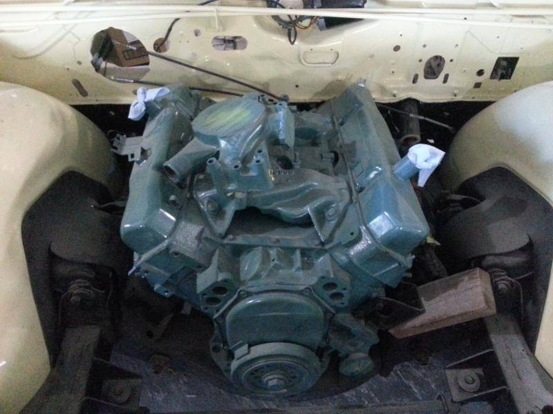

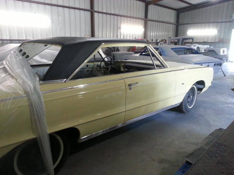

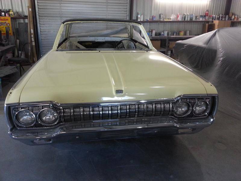

Missed you guys. Sometimes people come and go in your life. "Greater is coming" says the Lord. Life sometime throws you a curve ball. You either swing and hit or you miss. I choose to hit. Being a "girl", I cried when I saw what my baby looks like. It's ok to cry. Here are the latest pics. Still looking for a left motor mount # 2465861. If anyone can help with info about new or used...let me know. Like I said....I've missed you guys...but I'm back. 20131102_130610.jpg20131102_130630.jpg20131102_130925.jpg20131102_130649.jpg

Great to see you back in here, Marian. I sure have missed seeing the photo updates of your sweet Dodge Monaco. Don't know if it would work for you, but I saw this motor mount at NAPA:
http://www.napaonline.com/Catalog/CatalogItemDetail.aspx/Motor-Mount-Front/_/R-BK_6021118_0409067519
Yes...but thank God for therapist and medication. I don't want to scare anyone but things are changing. Now....I need a motor mount and I don't feel like paying out the vagina. LOL yes, I just said that.

Unless you have or have had a 65 and tried to find the left side mount one would assume the listing may be correct. The fact is the left side is specific. The mount shown on the right is the driver's side. As you can see, it does not resemble the NAPA one. The passenger side mount has only one bolt and a locating nub for the frame where the driver's has two bolts through the frame.
