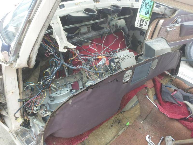

Pulled the dash in one of my Imperials today. It makes me appreciate the evolution of Chrysler dash configurations. These Forwardlook cars don't have a bulkhead connector or even a fuse block. Pulling the entire dash like this is also the same procedure for replacing gauges, speedometer or even the parking brake lever.

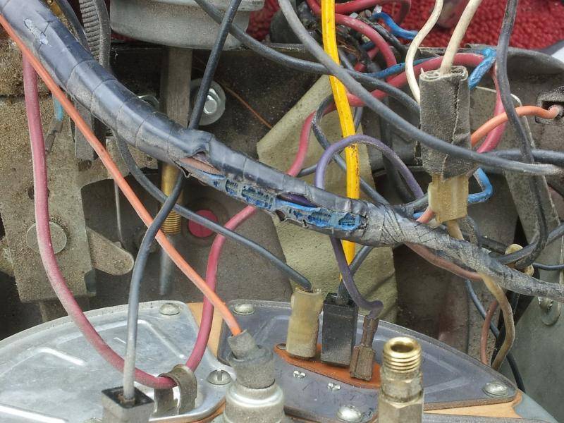

My problem started with a simple shorted out wire in the engine compartment. It melted the harness all the way to the ignition switch. On the bright side - I'm lucky I noticed it happening and was able to disconnect the battery in time to prevent a fire.
Here's a sample of what the wires looked like behind the dash

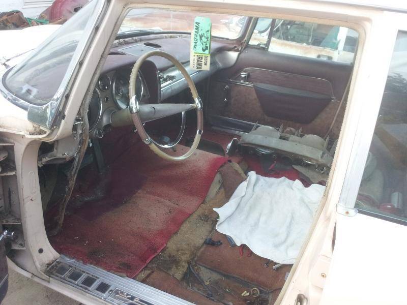

I got the dash back in today and everything works! I forgot how noisy a mechanical clock can be. Another bonus was getting the neutral button starter hooked up again, no more button under the dash now! I still need to put in a few trim pieces and the bench seat but at least I got a driver again.
