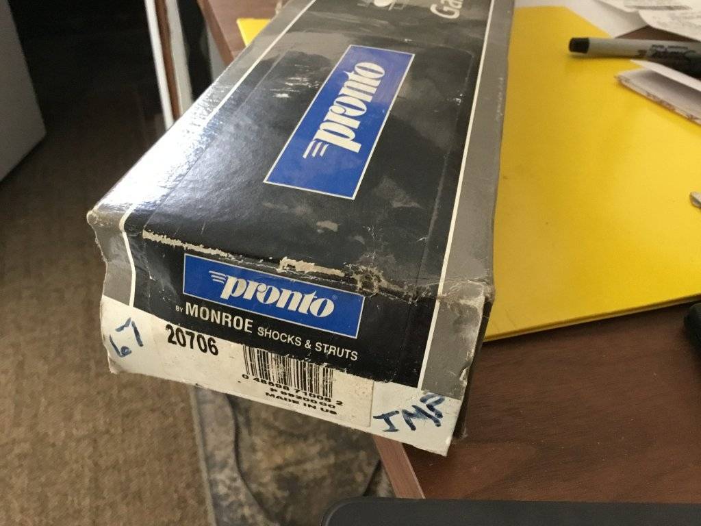

A new pair of Monroe Pronto shocks still in their boxes from about '95 according to the instruction sheet inside, measure 15 9/16" to 26 1/4". These came with my '67 and have a number 20706 on them.
Thank you Matt. As I suspected, the Imperial rear shock is almost 2" longer with a 1+" longer stroke than my Fury wagons shocks.
Might be the ticket to smooth out the ride.
