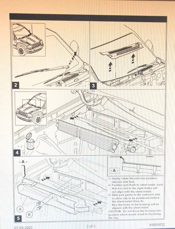

My 67 Newport gets a lot of leaves and dust blowing in from the floor vents and sometimes the heater box. Has anyone devised a way to improvise a cabin / cowl filter?
If not, I’m gonna try.

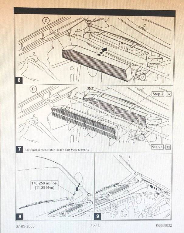

This is kit I bought to put one on an 08 Grand Cherokee. Can't say if it would work for you, or even if you can still get them, give you somewhere to start. Whatever you do though will be under the cowl, I'm not sure how hard or easy pulling that off to change or clean a filter Good Luck.
