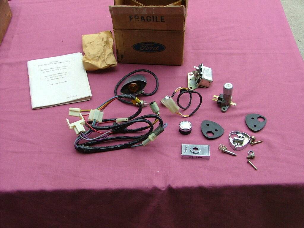

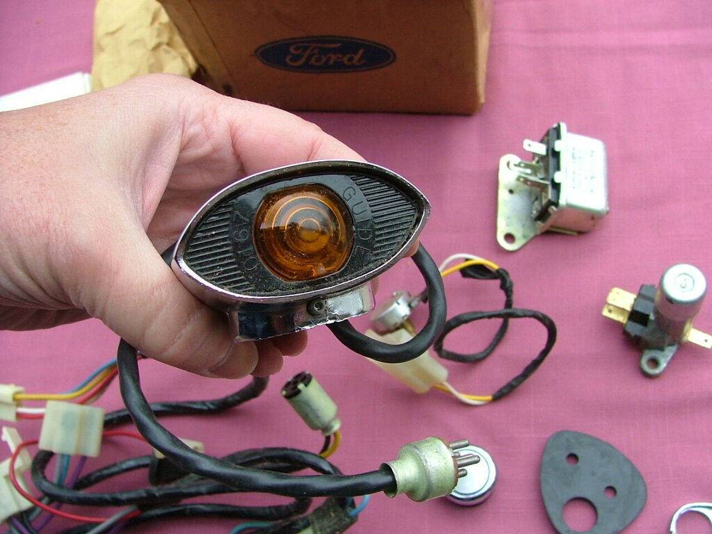

I have been considering off and on down the road of modding in a auto-dimmer setup for my car (just because it'd be easier than manually pressing the floor button, luxury and all that), but what was interesting to me was upon googling, the actual autronic eye was practically impossible to find, at least a Chrysler period-spec model. Until I noticed this eBay listing that had this:
So my question is, did Chrysler just outright buy the parts from Ford? I know that's not exactly unheard of from car companies to sometimes buy parts from other car companies (I know AMC did it with their transmissions, they're just GM units), but I find it interesting they did it with this year in particular, from the looks of it. Especially since Chrysler already had auto-dimming on their earlier years.
It's actually a General Motors unit, more specifically it's made by Guide, GM's lighting division at the time. All the auto dimming units were GM, going back into the 50's.
The Twilight Sentinel was also manufactured by Guide, though the Chrysler units were modified to turn on the reverse lamps when the delay was activated.

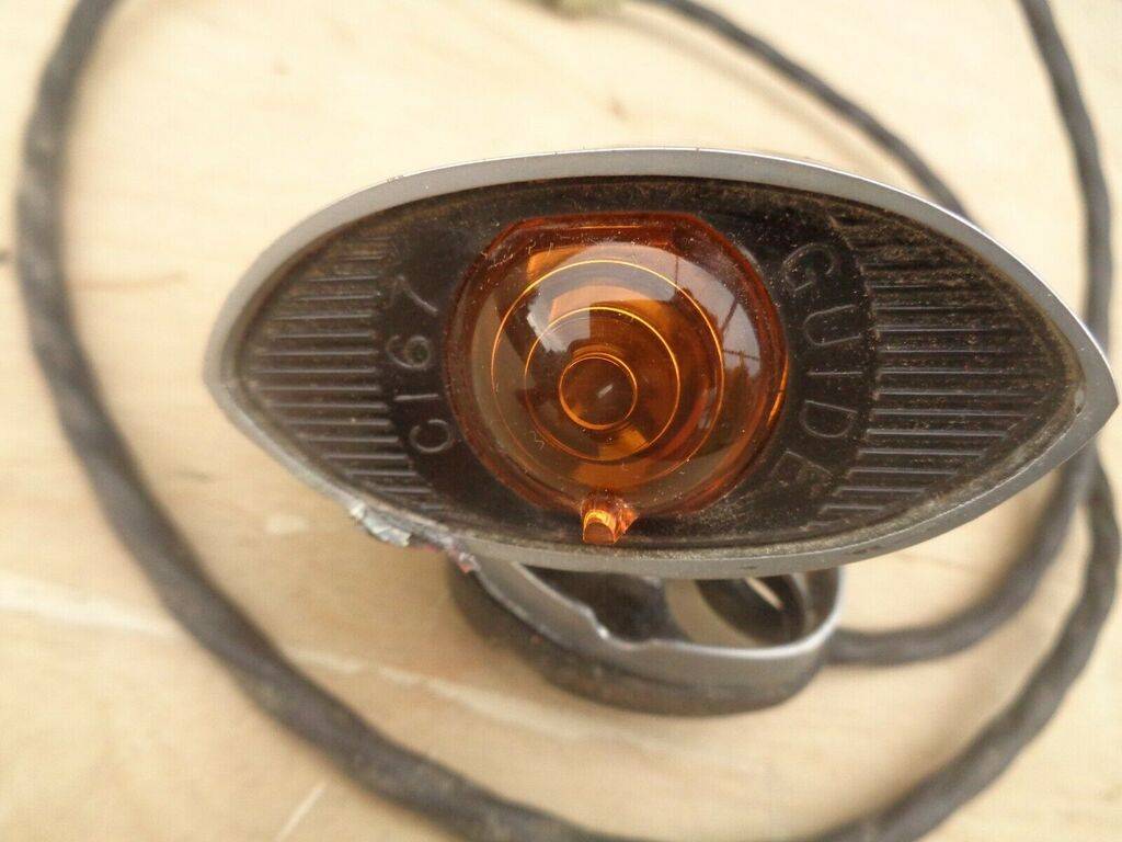

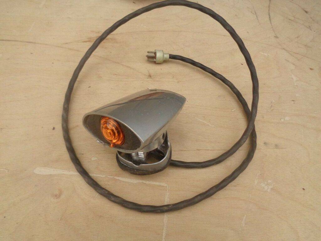

Just took a look online and yup. Seems to match up perfectly. Saw this listing, also on eBay:
Interesting they decided to outsource that instead of doing it in-house. Would the Chrysler reverse-light modification be in this autronic eye, or in the actual relay/hardware that the autronic eye wires into? I'm not actually sure if my manual has a section for this (it might, it has the other options in detail), so I'll have to take a look.
Edit: Also, that listing explains the Ford packaging, as they were sometimes used on Lincolns as well, evidently.

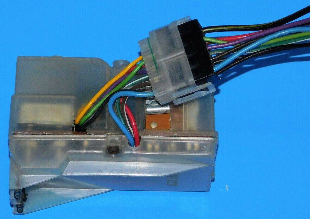

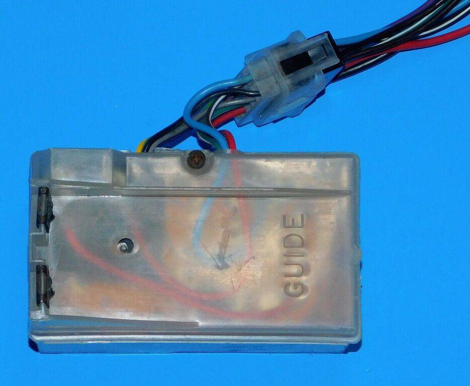

This '65-'66 Cadillac Sentinel amplifier looks identical to the Chrysler unit, except the case is transparent instead of black, and I think the purple wire has a separate connector on Chrysler.
