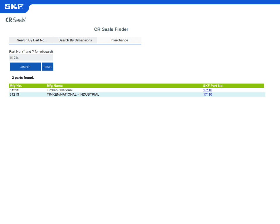

I've been using 8121S on my 70 Chrysler.
Also crossed the Napa part back to National..same thing.
CR Seal Finder
See attached screen shot
