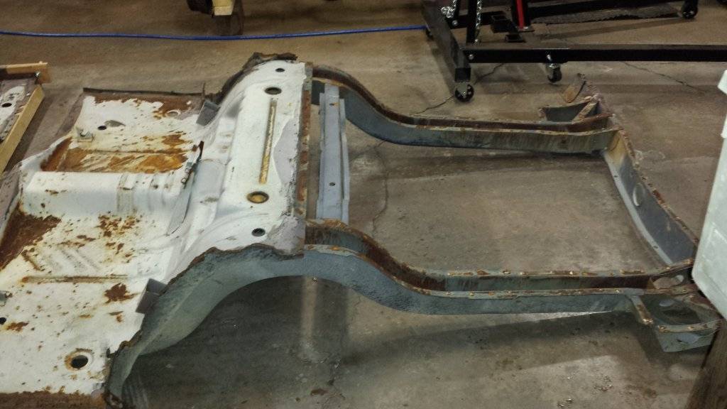

Well the rear frame and front Stub are Fury from my Cdn Polara...
The donor parts all came from that 65 Fury
Again the frames are identical but I did have to add my rear passenger seat brackets back into the floor pan....
the floor pan front section is identical for all Fury's/Polara's/ Monaco's
