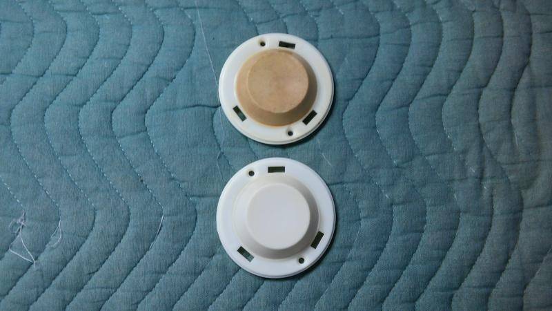

During the interior restoration of my 4DSD I bought new repopped lenses for the sail panel lights that I added. The lenses from a parts car were really discolored and stained after 48 years.
Since I had replacements, I figured I would experiment and see if I could clean up the dirty ones.
So I let one soak for about 24 hours in the cheapest bleach that Dollar General sells. No scrubbing, just soak, rinse, and dry.
Here's what I ended up with:
They both looked identical before the bleach. So if you have a lens that's not reproduced and discolored, it might be worth a try.
Hope the input helps.
John
Does the bleach affect the plastic structure (brittleness, etc.) ?
No, not really. It's still solid and useable for a driver.
The pic doesn't show it, but it does still have a slight yellow tinge to it.
I think if you left it in long enough it would probably disintegrate eventually. Kind of like a metal piece in vinegar.
But that's speculation on my part.
