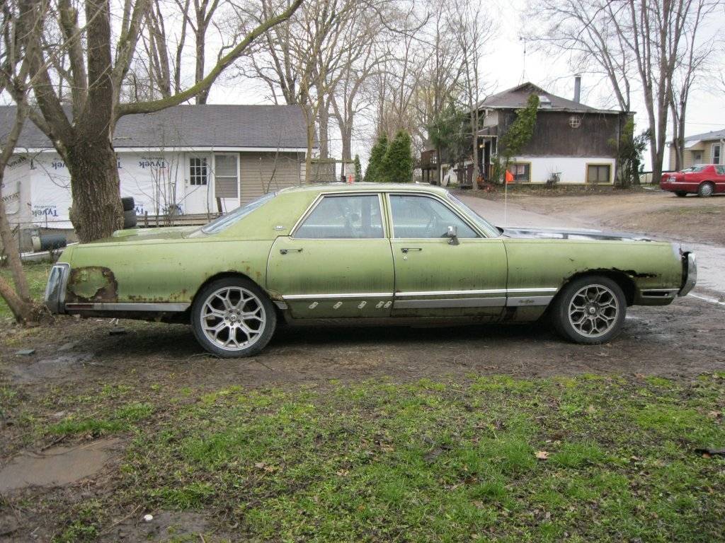

I'm not much uv a restorer really. I admire peepl who can do it, but I don't feel the motivation. Also, I like to not hav to worry about scratchez and accidents. I'm more into making it work well better than orijinal.
Still, I am spending sum time to make the fender look haf way desent.
Herez a few piks:
I hav Motegi 17" front, 20" rear with BF Goodrich G-Force tirez. They get insane traction until the temp drops below 25f, then it changez to sliption! I'm thinking uv sending the fenderz to the Vatican to ad to their holy relics colection.

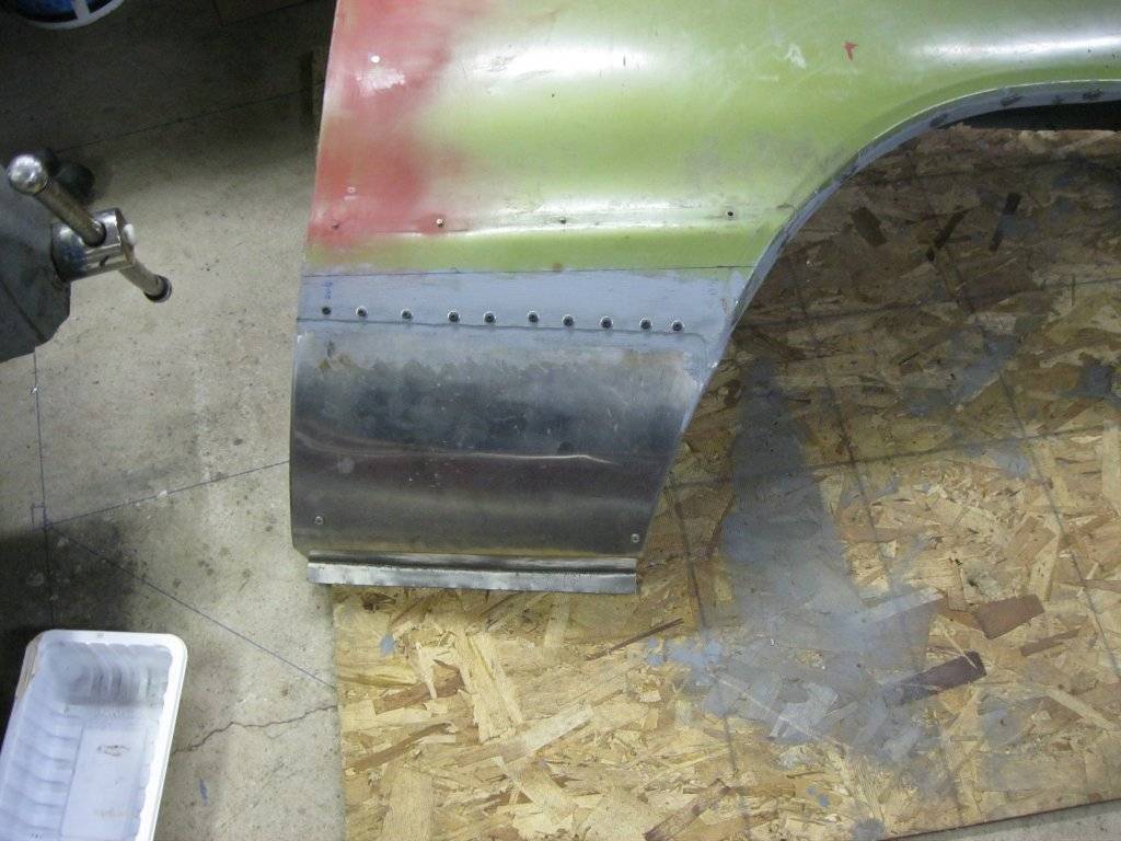

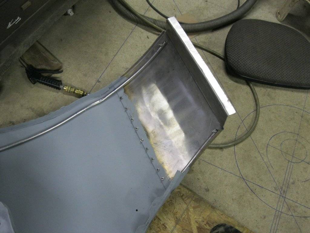

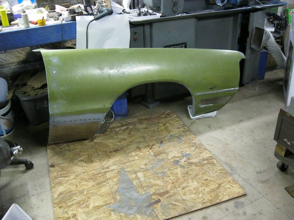

Herez the new PS fender in progress:
The bottom 1/3 behind the weel well iz stainless steel and I added SS tubing stiffening brasez in place uv the formed steel brase that wuz hiding rust. The rest I sanded and sprayed with rust converter and cold galvanize paint.
