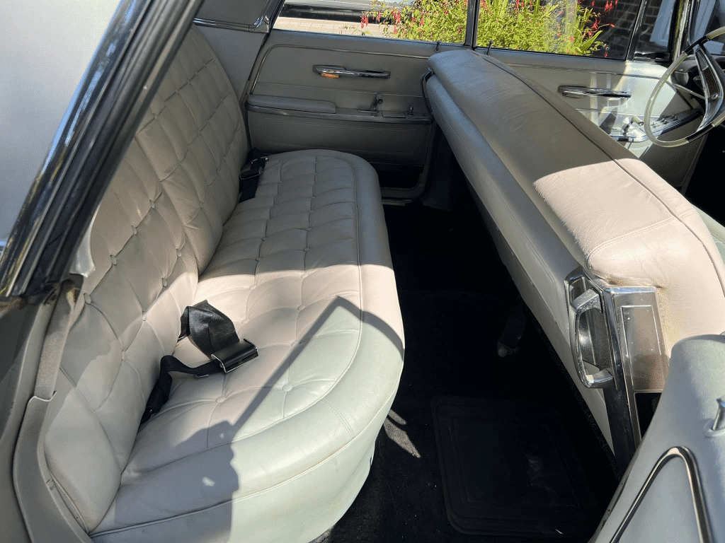

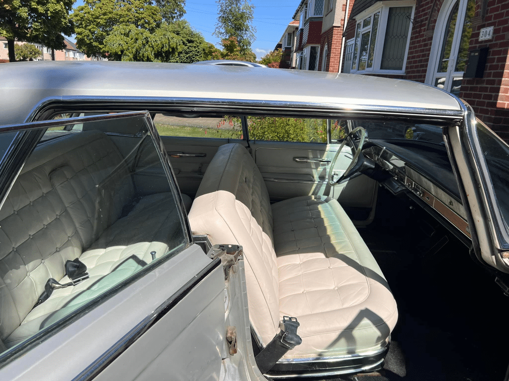

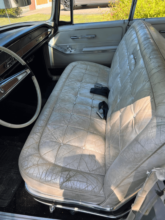

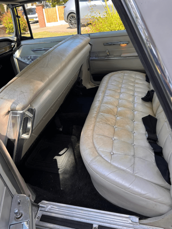

@CBODY67 - I've seen you mention the issue with the pearl colors in Chrysler white interiors before,so I was intrigued when I saw this on Facebook yesterday from guy who restored his Imperial's interior:
He said he used something called Leather World Tech Chrysler Pearl white dye, available here: Leather World - Leather Repair Products & Kits | Leather World Technologies
I couldn't find the actual product as he titled it, but I suspect they'd advise one on what to use if it was suitable.
Here is what he says, and a couple of pics he posted:
"I managed to sort the sun bleached seats on my 65, two weeks of leather cream, 8 hours prep and 6 coats of leather tech Chrysler Pearl white dye. Really pleased with the results and what a change from the horrible stained leather "
BEFORE
AFTER

Thanks for posting those pictures! Never knew the cracking could be "fixed" so well on automotive leather. He did an outstanding job.
Thanks for tracking that stuff down!
The Chrysler vinyls from back then have the pearl tint, as the fabrics have a metallic bit in them, too. Put them up against a Ford or GM fabric of the same color (except possibly black) and these things become very apparent.
