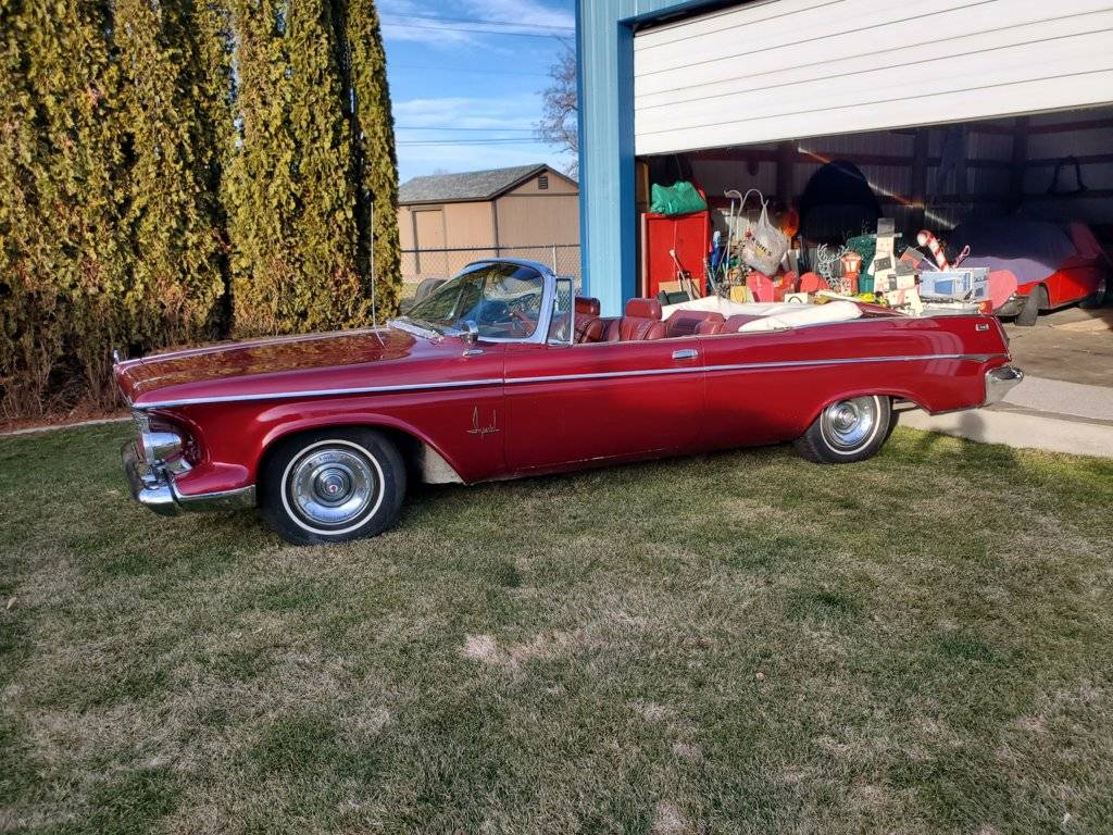

I drove the car home while there was a fair weather day . Snowed the next day! Now I can start fixing things! Thx all for the input so far!
lovely car, lets see some more pics !
im curious to see what the front seats are from, doesnt look original to me
you are observant! Not sure what seats are from, but I did get the original bench seat as a core to work with. My plan is to get that original seat back in the car. I need to get some quotes from local Spokane or Coeur d'Alene shops to match the back seat. When I get more pics, I will post. Thanks

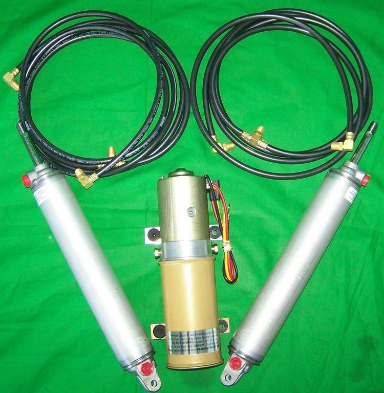

I pulled the back seat out and discovered that the pump motor is not OEM. It is a 2 wire motor with a dc reverser module cut into the wiring harness. Power across motor case (gnd), then either wire, nothing. power across the two leads, big spark. No motor movement. Looks like I will have some fun sorting out the work that was done. So much for easy diagnosis/swap :)
Wow what a stunner! Congratulations!:thumbsup::thumbsup:
From this distance the seats look like they're from my '79 300. Are there chrome buckles on the seat bottoms and the backs?

1960 1961 1962 1963 Plymouth Dodge Convertible Top Pump, Hose, Cylinder Kit-NEW | eBay3AMEBIDX%3AIT&_trksid=p2060353.m1438.l2649
Click on the link for the "store" to find what you need.
