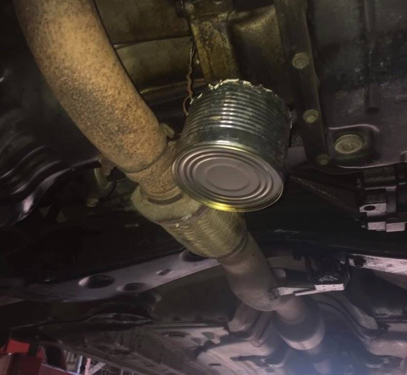

Road worthy is the problem. I had and explorer with a rear main seal leak and used a foil
Pan and some binder clips to make a catch pan. Felt real sturdy until I started driving and saw it in the rear view mirror. I then used aluminum roof flashing on a roll which is my go to… because I have an entire roll…and that worked with screw in the bell housing. Anyway I’m thinking one or two of those big hose clamps will fit around your pump and u can feed it through whatever material u can bend and still withstand the wind. I used one of those big clamps to make a heat shield on one side of the pump do I know it fits
I missed the "road worthy" part. Nothing I suggested will fasten on the car. They would be good to pull out of the trunk though.
Found a picture showing the Pig Mat absorption pads tucked in around the pump. One underneath and one behind. They stayed there till I sold the car, even at highway speed.
