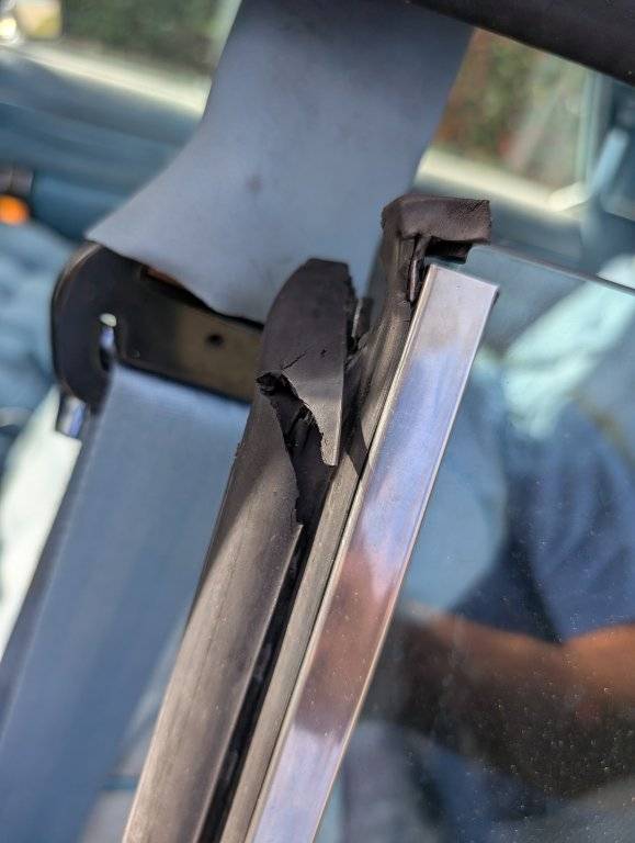

Is this fixable? Special glue?
rowjelio
Feb 6, 2025
50
49
California
I feel like there has to be some kind of glue I can use on this, please tell me there is, it's hanging by a thread haha
The problem is that the oils in the rubber have evaporated, which is why it is more brittle and a bit smaller. This process will not stop, unfortunately. Rather than "glue", you might try some high-heat black silicone sealer instead of the hard glue products? After the sealer cures, carefully put things back into place and possibly use some strapping tape behind it for additional support.
Just some thoughts,

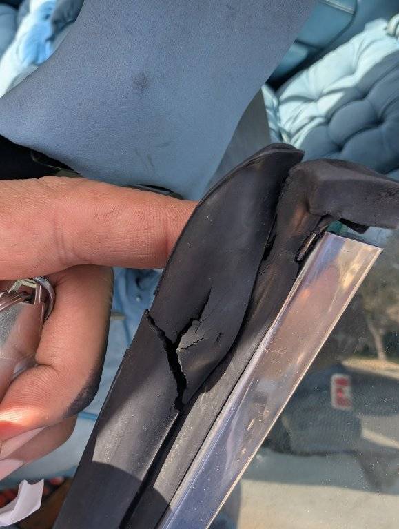

Okay so maybe I had cheap crazy glue but it didn't work at all, like not even a little. So I bought some 3M black weatherstrip adhesive, worked great! Doesn't look so nice up close but really can you even tell when you're not up close ?

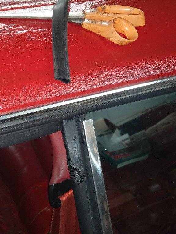

Here's my repair on same part. 2" of weatherstrip was completely missing on top. Piece of rubber u-channel, cutting and lots of RTV did the trick.
Also thanks for sharing You pictures. I did not realize there should be rubber piece extending over glass corner. Maybe I can try to replicate it with RTV.
Repair approved. Luckily You still had the torn piece intact.
That's very clever! What's the whole thing look like ?
