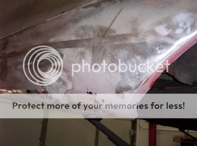

My trunk floor pans are in great shape but where it curves down, behind the wheel, and attaches to the rear quarter panel it is in bad shape on the right side.
I found a site that I believe carries what I need. http://www.autobodyspecialt.com/cgi-bin/commerce.cgi?preadd=action&key=MP-C107
They call it a trunk floor extension, is this indeed what I need?
You need a quarter panel extension, I believe. I do not think these are being reproduced. The pieces in the link go inside. PM azblackhemi, he'll know what to do. He's an expert paint and body guy.
The piece that attaches to the main trunk floor and turns down to meet the bottom of the quarter is a trunk floor extension at least on B & E bodies and I am very familiar with them.
A good body man can patch that up with new steel. A really good body man will have very, very little filler in it when done.
