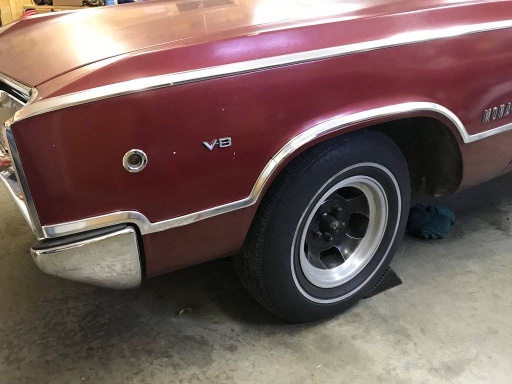

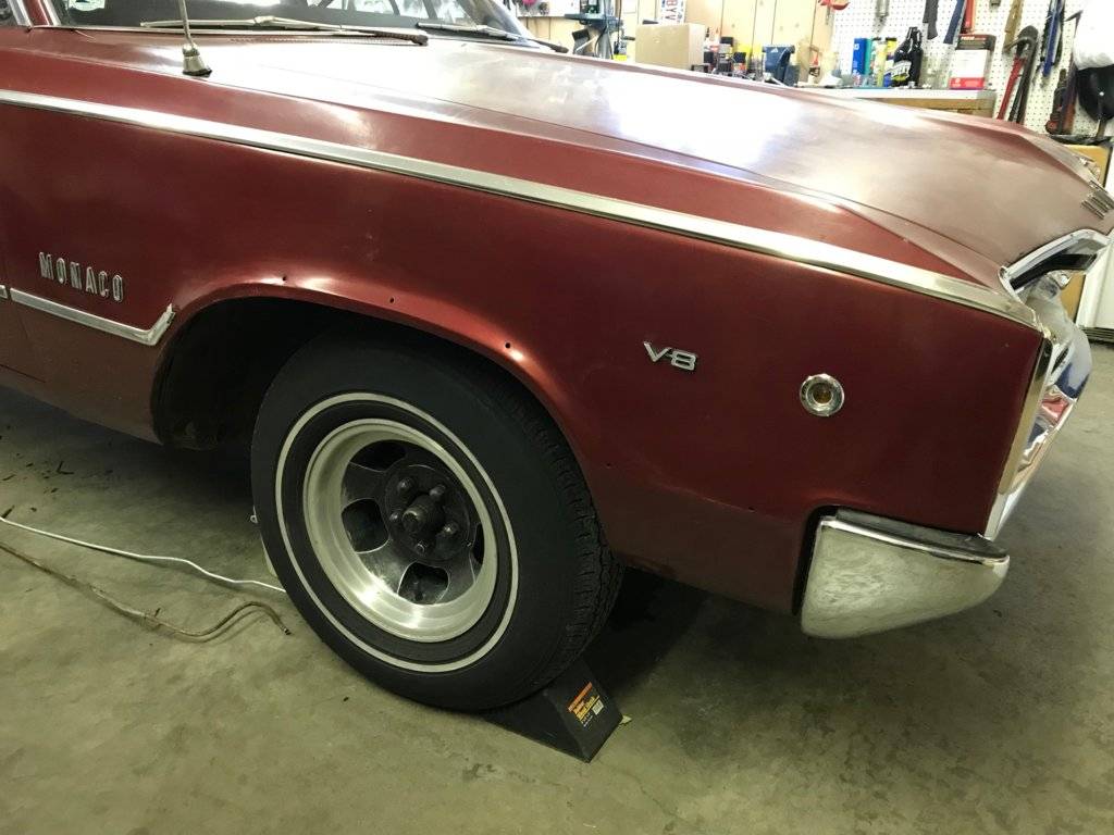

When I bought this wagon the seller promised me he knew where these trim pieces were. After several unanswered follow up attempts I have come to realize he is a flake. Now the search is on to find them and I'm wondering if other wagons from that year might have the same ones, ie. the T&C or Suburban. There are very few 68 Monaco wagon parts cars out there so if anyone knows where one is I'd be very grateful. Thanks
Left side
Right side - 2 pieces missing
Those will fit from ANY 68 Monaco of the same model, and are not wagon specific.
Try Murray Park in Tiffin Ohio.
Are you sure Ross? Those look like they are the woodgrain moldings, not the standard wheel opening molding. The non wagon have wider ones it looks like.
The wagon moulding is wider I believe and it comes all the way to the front vs the standard one stops at the bumper.
Thanks for setting me straight on that guys... still, try Murray Park and see. Also, look up the part numbers and see if they show up on PartsVoice.com

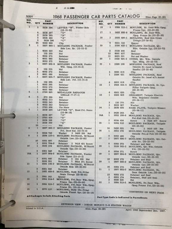

Here you go had my parts book open.
Number 3 &4
2807988 molding package fender wheel opening
2807986 molding package fender side lower front.
