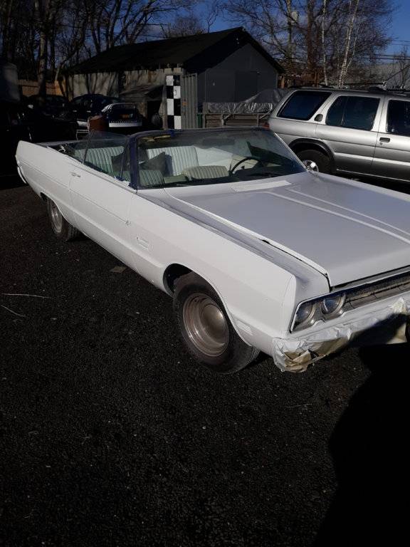

1969 convertible
Auto transmission
1969 convertible
Auto trans
