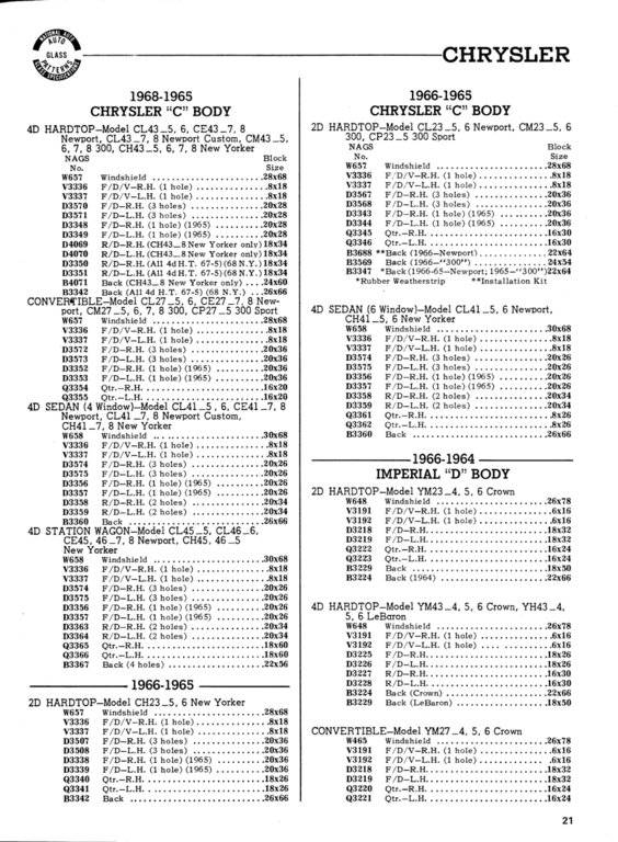

Does anyone know the NAGS number for that windshield?
If you have that number, any independent glass dealer should be able to give you a reasonable quote. Anyone that is telling you it's some rare hi priced special order custom $1000 windshield is full of it.

I have the numbers for Chrysler. I suspect they are the same, but wouldn't count on it...
My references list Chrysler # 2664210 (clear) and # 2664211 (tinted). The NAGS for both is listed as W0692.
The information you supplied has the windshields for the 1965-68 C bodies, except for the 1967-68 Fasttop. Other than that the information will cover all but the fasttop for 1965-68 Fury, Polara, Monaco, Chrysler and 1967-68 Imperials. Plus the 1964-66 D body (Imperial).
