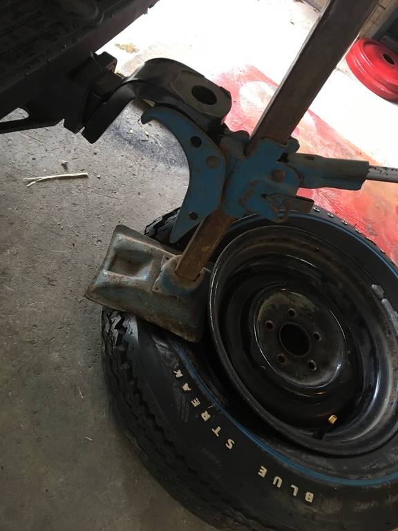

The bumper jack for my '74 T&C leans like the Tower of Pisa. Maybe they designed it this way to compensate for the curvature of the upward bumper movement?
I thought that the jacks for my mother's '67 Newport and my '73 Scamp pointed straight up when in use. The base doesn't look like it's bent. I haven't seen the aforementioned cars in over 30 years, so it could be that I don't remember jack.

Either the jack is not in the base all the way, or the base has been damaged. The jack like you pointed out should be at a 90 degree angle to the bumper. Also do not forget to put some kind of block by the opposite wheel so the car does not roll off the jack.

That jack is a little exaggerated but it should be a few degrees like that, when you jack it, you'll see that it straightens up to 90*. The higher you go the more forward tilt there is and that makes it real dangerous situation real quick! Always try to keep the jack as perpendicular to the ground as possible when vehicle is lifted for the safest position. Also a block on the front wheel also helps secure the vehicle as well. Good Luck

L@@k at it, it’s made that way. That’s a slot jack, if it tilts forward the slot could come out.
Long wheelbase car needs to be lifted higher and it will straighten out when going up.
Hook jacks don’t tilt as far for sure.
Good call! I was going to ask if perhaps it had the wrong hook, never seen the slots.
