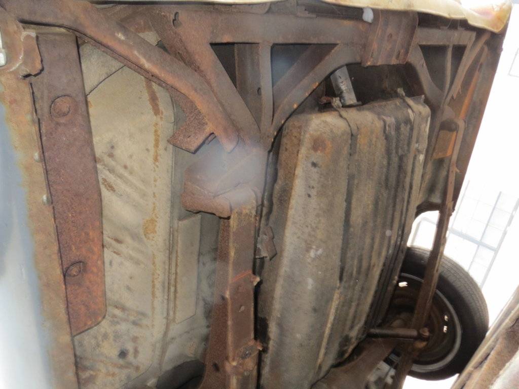

Here’s the ones on the rear corners of my ‘64 Imp. They’ve got away at least as much as a cast-iron exhaust manifold and may have been limited to the Imperials as they were the top of the food chain in the luxury line. I am not sure though if they continue them after 66.
Wow that's some serious weight hanging there. Probably helped for winter traction too! Are they just bolted to the floor of the trunk? And where are the front ones located?
If I would've seen them on a car w/o anyone explaining them to me I'd have been scratching my head
Yes they’re bolted on. I haven’t actually seen the ones in front yet as they seem to be tucked up out of site and I’ve only just started playing with this car.
