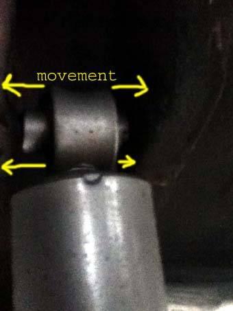

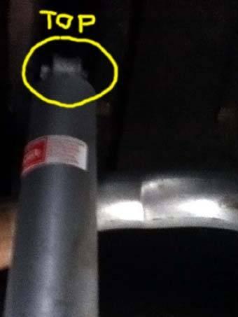

Every had the top of a KYB gas-a-just shock absorber (where the bolt slides through its rubber core) “jitter” back and forth while driving over imperfections in the road…potholes, speed bumps, etc.? See pics....
They weren't KYB, but yes. On mine the steel sleeve was about an 1/8 of an inch to short. I took them back for a different pair and they were the same. I guess I could have used some washers, but instead I was able to just squeeze the gap closed with the bolt.
I have also seen where the inside diameter of the sleeve was larger than the outer of the bolt causing up and down movement.
The steel sleeve that fits around the bolt on mine fits that gap, but the material (rubber?) covering the sleeve itself may have dislodged itself or has deteriorated and is now missing. I've had these shocks on since last fall and they did not start out this way. A malfunction or design flaw with the shock itself. Either way they should not be moving in such a manner.

I misunderstood you sorry about that. Aren't they ''lifetime'' warranty? Maybe you got a bad pair.
Yes, I believe they are. I think I purchased them off Jeg's. The fun will begin next week after the holiday. I'm not picky but I don't expect a part I buy to malfunction while performing what it was designed to do.

Maybe I'm being a stickler but again this does appear to be a faulty part on the shock. No telling what type of damage could be going on with it jittering back and forth on its sleeve. That's what bothers me about it.

I am writing in regard to a pair of KYB gas-a-just model shock absorbers I have installed on the rear axle of my vehicle. I had these shock absorbers installed in Fall of 2011. Recently I’ve begun to hear a frequent “knocking” noise emitting from the left side rear of my vehicle. After inspecting the area (and a visit to an auto repair shop) it appears on the head of the left rear shock absorber, the rubber material surrounding the metal sleeve (which the bolt slips through)has deteriorated or dislodged itself. This is allowing the head to slip back and forth on the metal sleeve, which is occurring while driving and in turn making loud “knocking” noises in back of the car. I have included a picture of the shock installed on my car as reference. Is there a known solution to fix this problem? I would prefer to have the shock absorber head to be completely locked down and not able to move about when driving.
