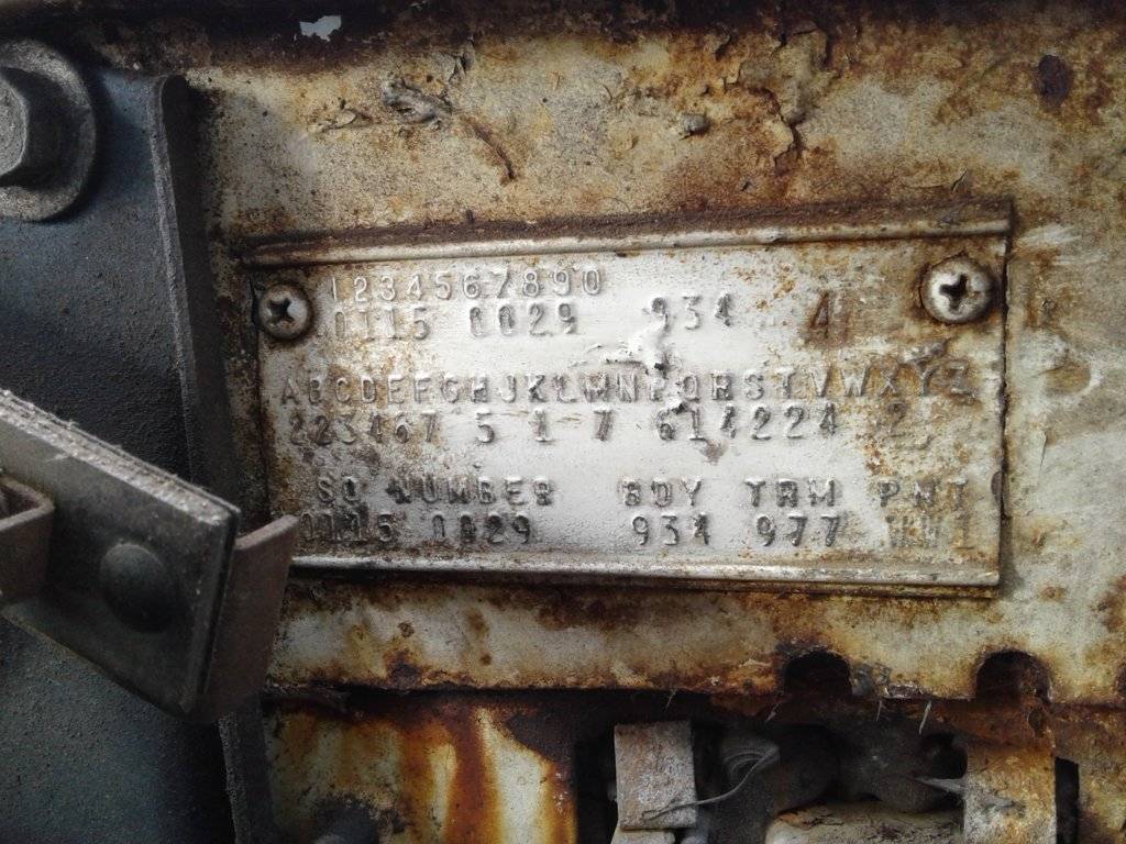

7. How do I decode the fender tag? The letters under the numbers don't make sense to me.

Here it is! Can someone please help with decoding the fendertag?
