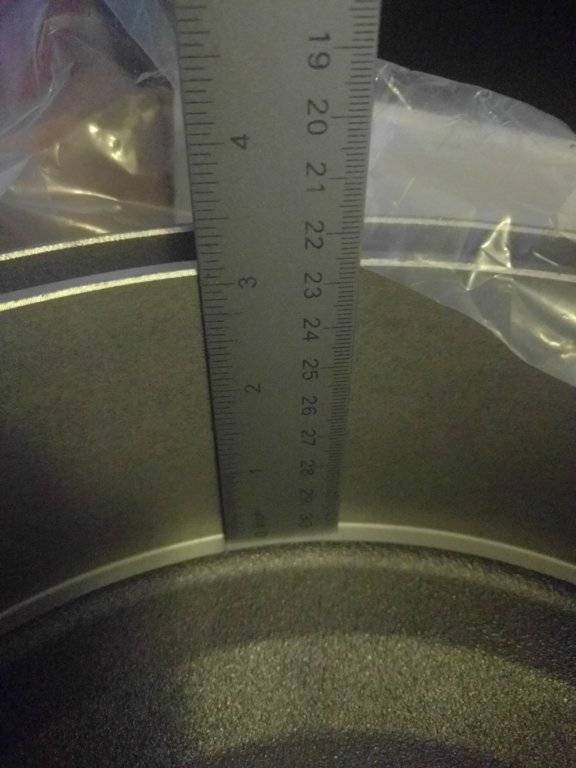

I just got two new Raybestos Drums delivered (982091r which... comes out as mitsubishi rotors lol) The invoice states what I ordered: Raybestos 1924R. They said for 2.75" brakes and when I measure the drum surface they measure 3". Is that correct or did Rockauto send me the wrong parts...once again? The difference between the drums for 3" shoes vs 2.75" shoes is: 3.330 vs 3.160...so should I not worry?
Put 'em on and see if they rub...

From what I've seen, there is some "gray area" between the 11x3 brake drums/shoes and the 11.2.75 brake items. In some catalogs, you kind of have to read between the lines, it seems.
