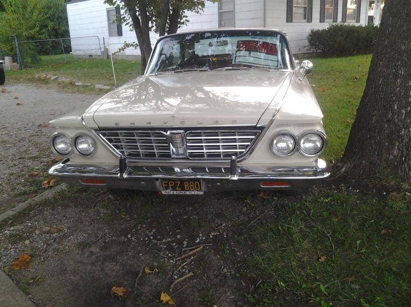

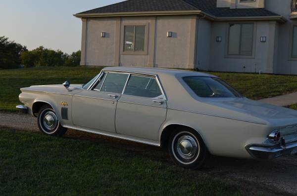

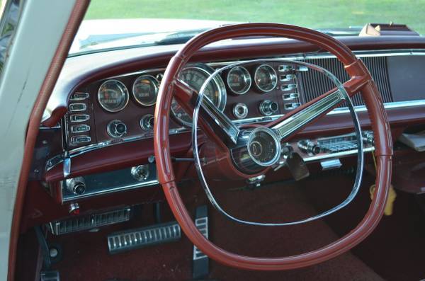

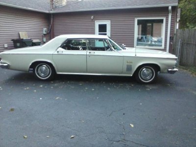

00N0N_33xpUZvJQcD_600x450.jpg01515_8czJLWU1v0R_600x450.jpg24078704-770-0@2X.jpgThanks guys for the replies, the gauge is showing empty. I have a week off in about a week so maybe I'll drop the tank then if I have too. There is vacuum going to the booster, so I guess it's bad. I will pull all the wheels as mention and see what's going on, I'm a novice at best but I've done drum brakes before, I just hate bleeding them. I guess I need to order a booster, the PO's mechanic told him the same thing that the booster was probably bad. I might as well change the master cylinder as mentioned, they're pretty inexpensive. Thanks again and here are a few pictures of it before I bought it, I really like the car so far, even though I haven't driven it!

Beautiful new Yorker. I like the red interior.

Welcome Joe! I love the details on that dash!
