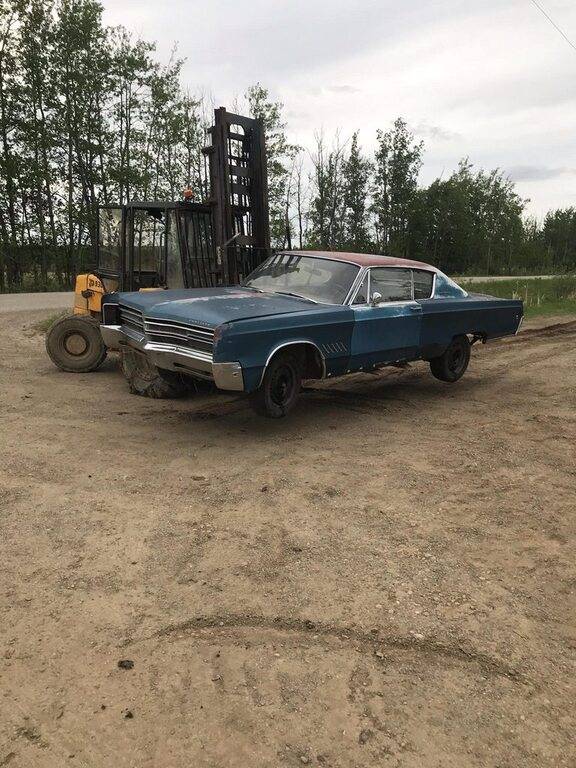

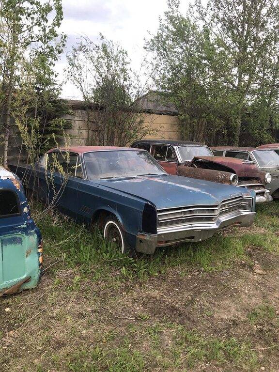

So loaded up the truck, hooked to my trailer and made the 5 hour drive one way to go get the car. This is how I found it when I arrived...
Guy used a big forklift to drag it out, he was going to drop it onto my trailer but I could see damage happening that way so I said I would swap on some rims and tires I brought with me and use my 10 ton chain drive come-a-long to drag it up onto the trailer. He said he'd lift it with the fork lift and then used his big cordless impart to spin off all the lug nuts for me...super cool of him since that would have taken me at least an hour to do by hand.
He then placed it with the front wheels on the back of my trailer to save me some more time, then I used my come-a-long to drag it up the rest of the way.

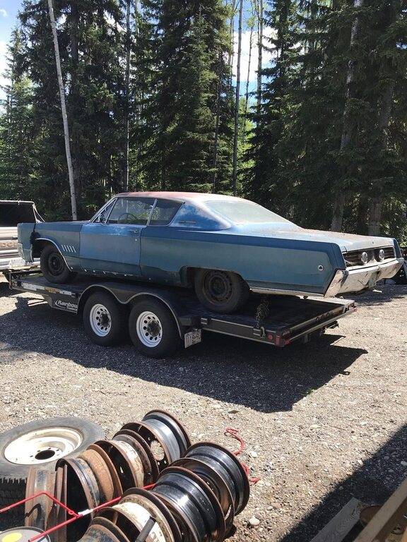

Ready to head home....
Next morning in front of the shop...Ol' Patches ran like a champ the whole way there and back, gotta love those 1st Gen cummins drive trains!

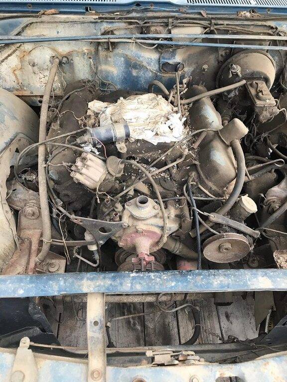

Guy thinks the motor is locked up, I have not tried to move it yet...

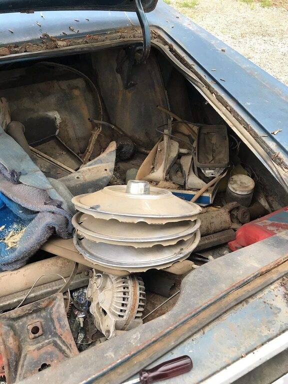

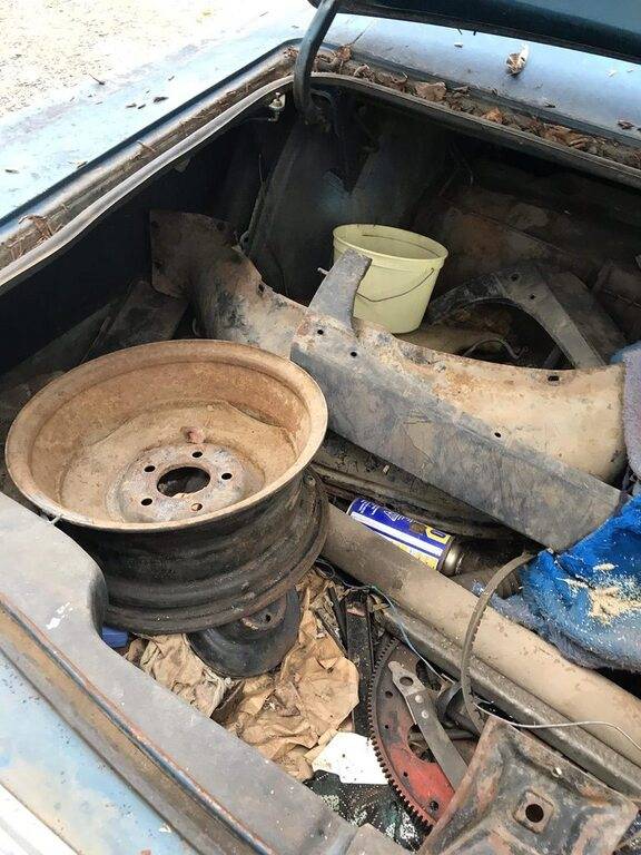

Trunk full of stuff...

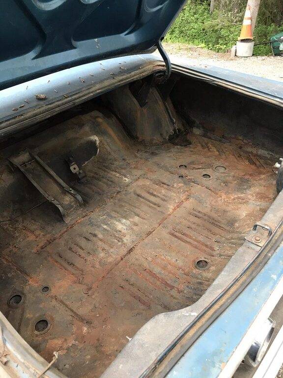

Sorting and cleaning today...

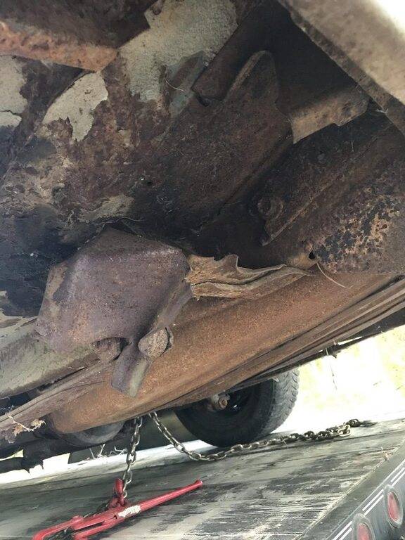

Saw this on the drivers side rear spring mount...guess it was towed out of a ditch maybe and tore the frame boxing apart.

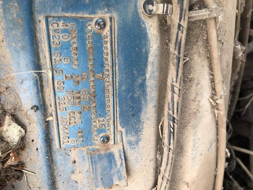

Fender tag is present and in great shape, and I even found a mint build sheet!
Guess all that newspaper inside the car gave the critters lots of nesting material and they left the build sheet alone....:) I haven't decoded the fender tag or build sheet yet, but the numbers all match.

Great score! Try turning the engine yet?
Don't look too bad for sitting out who knows how many years. The dash looks pretty gnarly though.
No not yet...I pressure washed the motor last night and got the car off the trailer. Will change the oil (used oil from my cummins) and filter, spin the oil pump to prime the motor, then pull the plugs and squirt in some diesel in the cylinders and let it sit for a day or two. Maybe my next days off Ill get a bar on the crank and see if i can get it to move.
