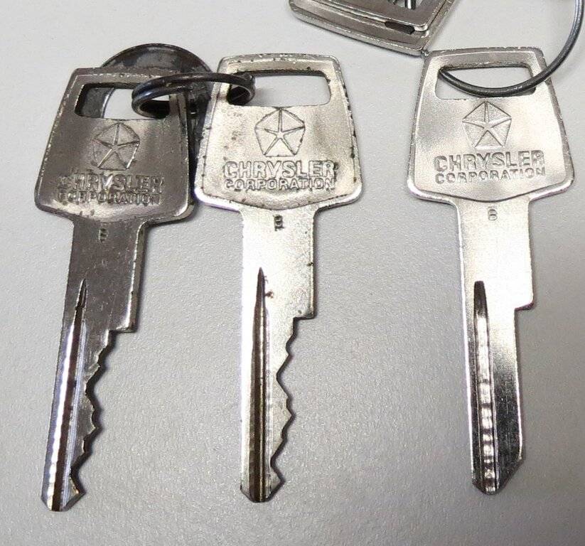

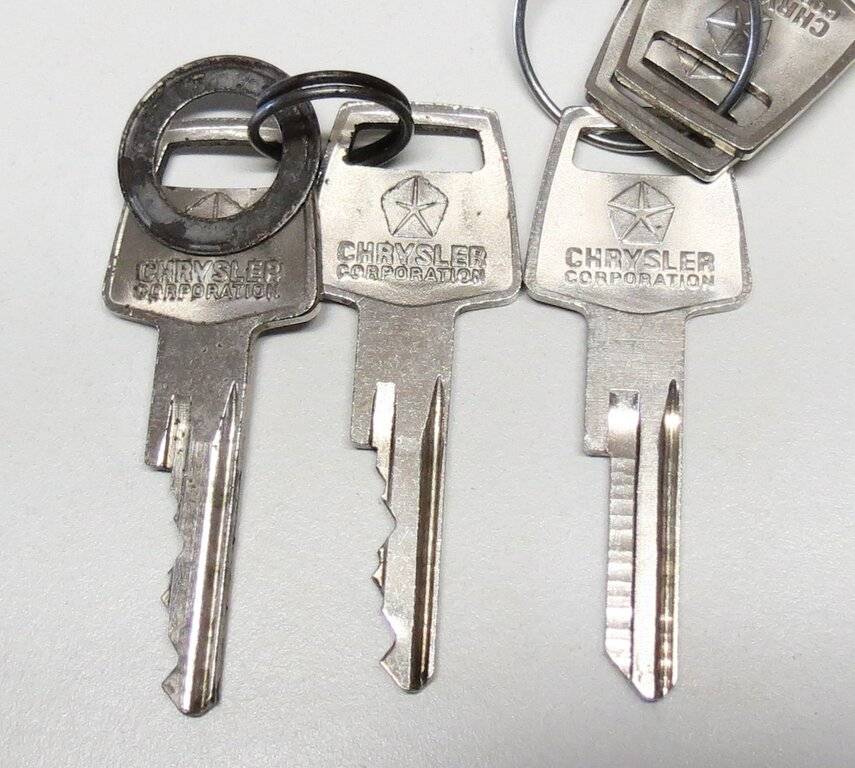

Good info cantflip. You got my curiosity up so I checked an original key from my '67 against my NOS blanks and low & behold they are cut different and do not interchange despite having the same heads. The difference is subtle and only on one side, you can see it in the 1st pic. The '67 square head type has the same cut as the '59-66.
View attachment 426138 View attachment 426139

Those aren't re-pops, it's my understanding from cantflip that some time in 1968 they transitioned to the cut found in your Type 2 without changing the head style. BTW I verified that the keys won't fit, they jam about halfway in. One aftermarket ignition key I found to fit every lock vintage is Ilco y152.

Unfortunately, there's no good way to tell. The keys pictured all look to be crisply stamped, I have seen some that looked almost right, but had obviously been made in a sand mold. IDK how many factory variations actually existed, but add onto that all the years of different suppliers and look a like reproductions and it gets nutty.
The uncut blank looks good, but it is disturbing that they all have the same letter stamped. :realcrazy:

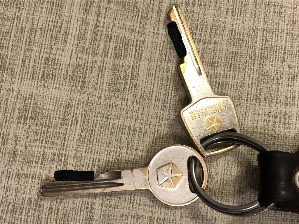

These are my keys for my 1968 Crown Coupe with a scheduled build date December 4, 1967. My brother's 1968 Charger trunk keys (3rd pic) has the same same small Pentastar with no wording and its scheduled build date is January 16, 1968.
