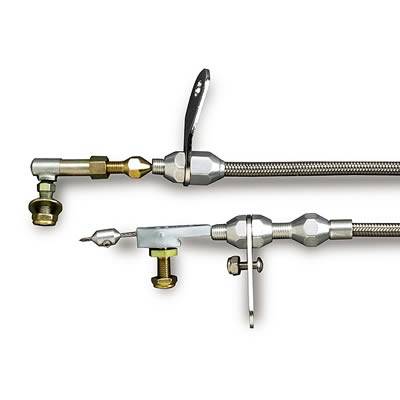

I can suggest using the Lokar kickdown cable.
Not difficult to install and adjustments are made easy at the throttle linkage.
Just make sure you order the correct length of cable.
Hope this helps.

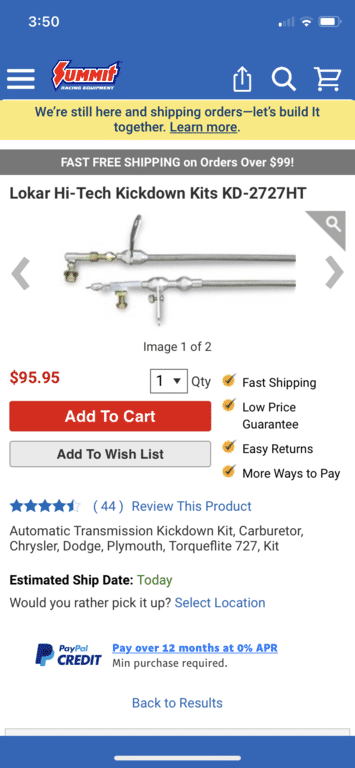

Lokar Hi-Tech Kickdown Kits KD-2727HT
Hope this helps.

You mentioned to make sure I get the right length. Do they make one that is specific to a 440/727 combination? Is your link to that part? Thanks in advance!
Mike
My link is just for a reference.
I suggest talking to Lokar or Summit to find which length you need.
Hope this helps

Went with the Lokar throttle and kick down cables. So far, I’m pretty happy with them. Summit Racing has there own ones that are less expensive than the Lokar, but are made by lokar. Weird, but whatever
