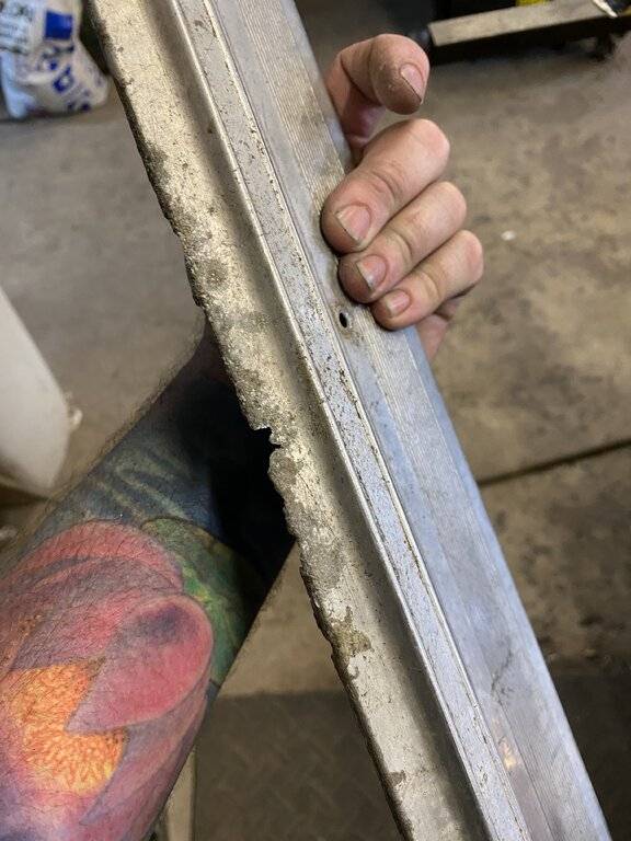

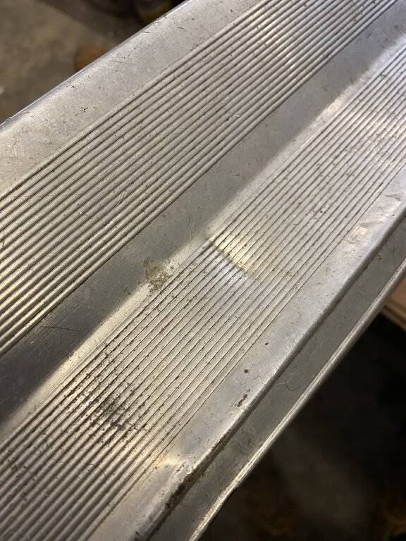

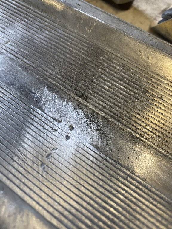

    Here are a few pictures of the condition of them before I started. There are some pretty major dents and dings on the drivers side. I wasn’t worried at all about the ones on the flat areas. My biggest worry was for the ones that were in the ribbed area. I knew I would have to come up with some creative things to repair those areas. 5F89031A-8403-4D2A-A4C0-EABEF58E9277.jpeg AC818E5D-459C-4DE9-8C1E-1110A33F1E45.jpeg BFCAC71D-A867-4E47-AB18-650B6E6EA170.jpeg

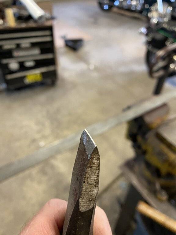

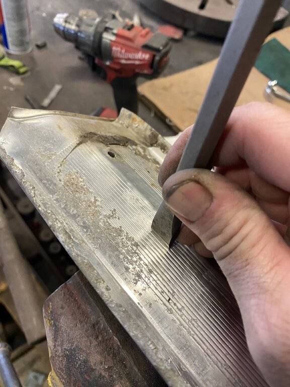

    I used a piece of steel, probably 1”x2” by about 8 inches long in my bench vise as a dolly. I don’t have any special body working dollies or hammers. I’m definitely going to invest in some because I really think I would have had better results if I did. I took two different sized chisels and ground them to a sharp point. After that, I hit them on the sander again to slightly flatter the sharp edge I did this so that they wouldn’t punch through the metal. I used a hammer to knock out the dents while the sills were laying on the piece of steel in the vise. D900D014-9DA7-4C3A-8974-924ED805E55F.jpeg 6C776600-DB1C-4C99-ADA8-26C280317824.jpeg DDEAF797-A4A5-4BED-B4B5-B40C053B453F.jpeg

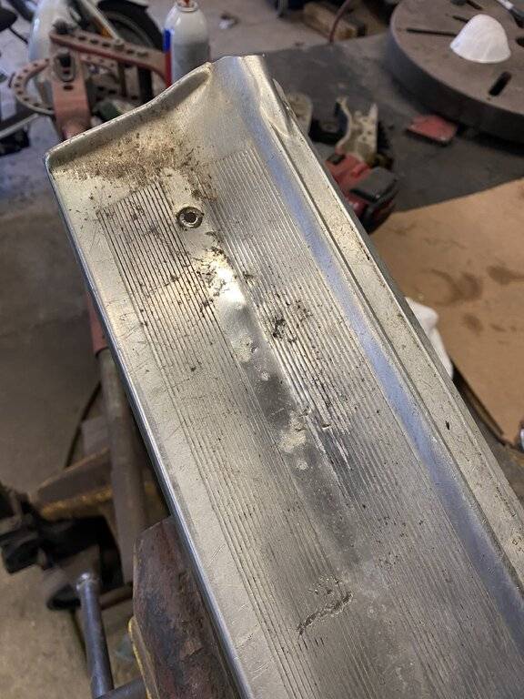

    Once I had the big dings knocked out I concentrated on the ribbed areas. After banging out those areas, it definitely effected the lines in the ribs. I laid the panel upside down on the dolly and used the small chisel on the back side of the panel to try and knock out the ribs and give them a little more shape. CCC51CE8-6B5E-4CCB-8257-2898ACE5AFDA.jpeg 1D1C6AE1-3E5B-40D4-B750-CE4F2B12A8B5.jpeg

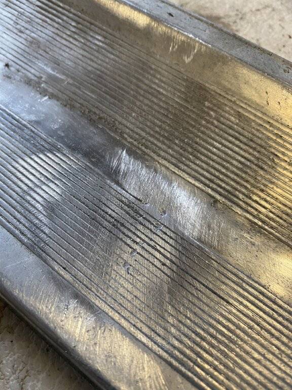

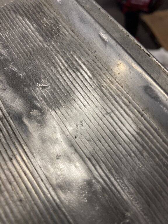

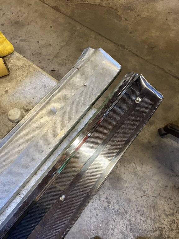

    Once I got everything knocked out I used 220 sand paper on a sanding block to smooth out any visible blemishes. Some of the spots were way too deep and I just couldn’t work them out so I did the best I could. BAE94742-5FEC-498B-ACDB-22C66CC10CD0.jpeg 39139916-CB8B-424B-B46A-46EE96984564.jpeg AC9E595B-BA32-4A1C-8BD7-EDA4B5129C3D.jpeg
    • Agree Agree x 1

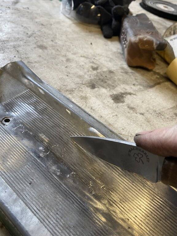

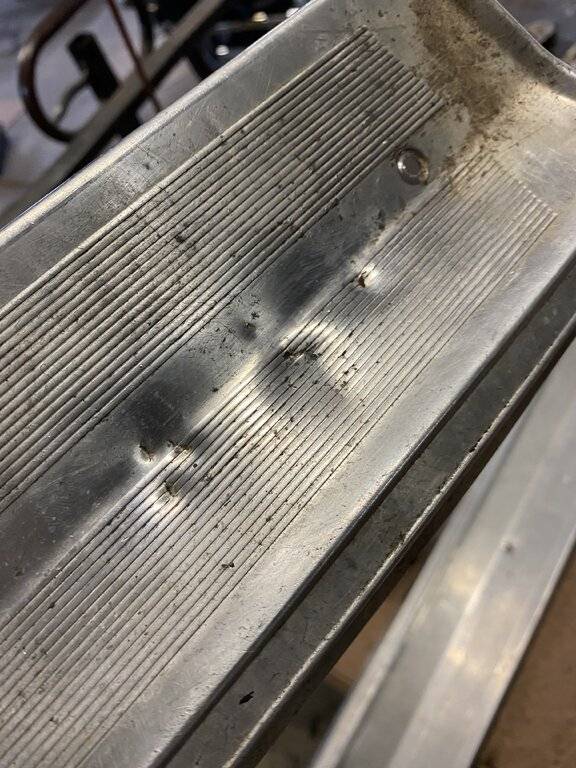

    As you can see, once I sanded the bad spots with 220 it actually made the ribs blend in and disappear, which I knew was a possibility. I used a bit of a crude method to correct it by simply taking my knife and running it back and forth to re-cut and connect the existing lines. FAB19B25-17F9-4D32-9F61-85173DCA5EAC.jpeg 7AD4C472-CF1A-4E18-BF37-1415BA13D25F.jpeg A0F3D61F-9E5E-496C-A8D2-2FFF9425AFA2.jpeg
    • Agree Agree x 1

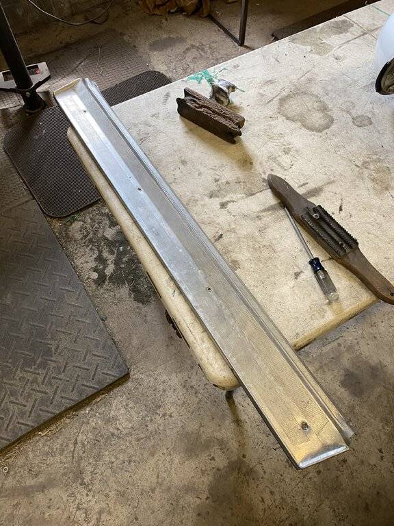

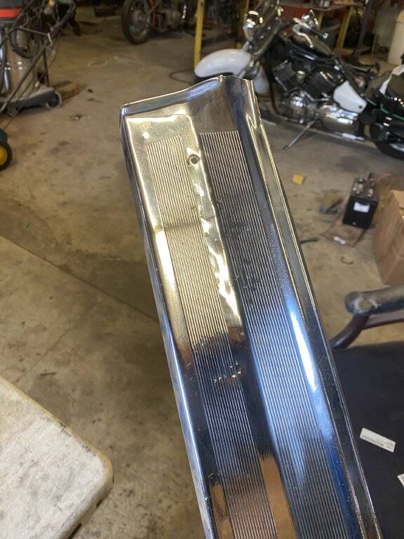

    After I was satisfied with the repairs I sanded the entire piece with 320. I then used a 3/4hp buffing wheel with a sisal wheel and brown compound to smooth out all of the scratches made by the 320 sand paper. After that I cleaned the pieces really good with acetone and followed up with white compound on a loose buffing wheel. They are by no means perfect because I’m not doing a restoration and wasn't concerned with them looking brand new. I definitely could have done a little better by having better tools and spending a couple more hours on them. I’m very satisfied with the results. I’m going to order some better body working tools and work on some of the other trim. Definitely a lot of effort by very rewarding. Hope this might help some of you out. Have a great day.
