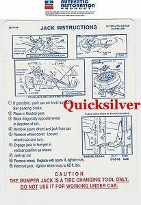

    My manual says to Never jack or support the car using the frame... where are the actual support/jack points? I jacked mine up under the diff and put stands under the front of the rear spring hangers to do the gas tank. I need to drop off the rear wheels to do the brake cylinders, where is the safest place to put the jack stands?

    The jackpoints are on the front/rear bumper. If you got the original jack, you will know how to use it ;)

    I wouldn't use the original jack to jack up the car by the bumpers except in dire emergency. That's a good way to tweak the bumpers so they're not lined-up properly anymore.
    I use my shop jack to lift the car by the frame, but 1) I have a flat pad to use in place of the cupped end that came with it, and 2) I only jack in certain places that I know are stiff enough to support it. With jackstands, when I put those under the frame I put a piece of 2x4 between the jackstand and the frame rail to distribute the load so it doesn't crush the frame member.

    I Agree Entirely with Mike66+.
    I've had a Couple of Cars Slide Sideways, SO Not Fond of Bumper Jacks at All.
    Also a Little Advice, ALWAYS have a Car Stand under the Car along with the Jack, I had an Old Friend who Died when a Jack Failed while he was Reaching Under a Car.
    Also if you are Changing a Flat on the Side of the Road Throw the Flat Tyre under the Car until you have the Spare Secured, It Might Just Save you from being Injured.

    Jack points are at frame, but use 2x4s on top of jackstands or you will get dents in your subframes.
