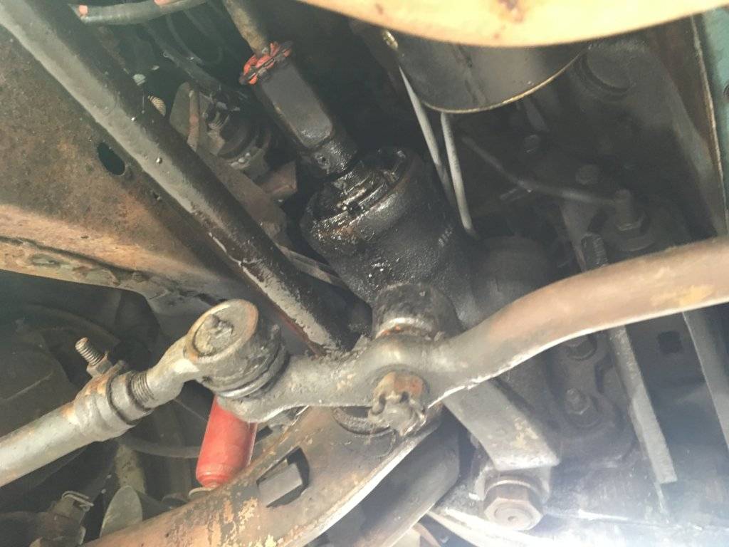

Steering box- FAIL. (major leaks at sector and worm shaft seals. Sector shaft “wobbling” side to side.)

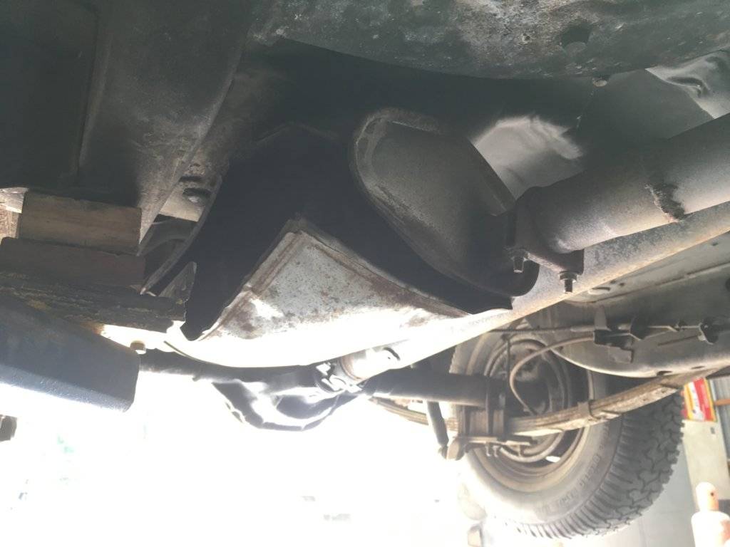

Exhaust system- FAIL. Somewhere between Washington and Georgia the transporter moved the car off the truck, causing the exhaust to backfire and grenade the muffler with the raw fuel being dumped into the engine by the dirty carb.

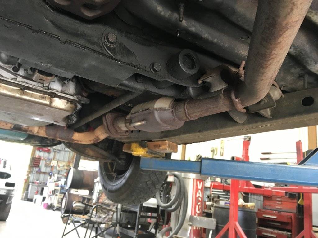

Incredibly- the cat converter in still in place!
A new exhaust needs to be installed, leaving the original y-pipe in place. (it's in good condition).

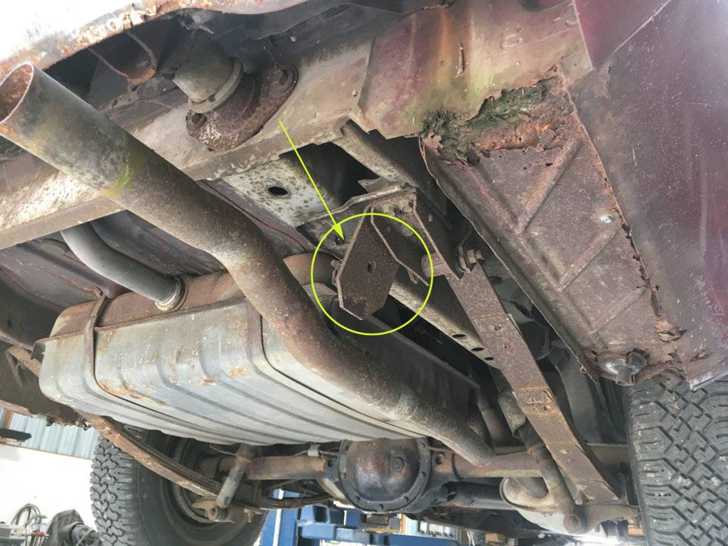

Can anyone tell me what these brackets are for? The car is equipped with the auto height option. Are the brackets part of some hitch system?

That was an epic fail on the muffler. Brackets appear to have been part of a light duty trailer hitch, although no one in their right mind would use that type of mounting. Steering gear is probably shot, although you might try to adjust it as that will sometimes slow down the leaks if the adjustment is way off. Most of the time, the gear is just worn and needs to be rebuilt. Find a quality rebuilder and for God's sake do not put a Cardone rebuilt gear in your car.

Agreed. (my most recent Cardone experience with a distributor was a hassle). I had thought to have FirmFeel rebuild it, as they have for my 71 NYer and 77 Cordoba. ACDelco offers a reman, but it appears to be unavailable through any current vendors. I am thinking of taking a chance on a Lares reman currently available.
Lares has always done good work for my various projects. Several vendors sell the Lares units or you can send yours to them and have it rebuilt.

I didn't find any evidence of a hitch ever being mounted on the bumper or anywhere on the frame, thus my puzzlement about the brackets.
With the advent of energy absorbing bumpers, hitches could no longer be hooked to the bumper. The shock tubes that the bumper was mounted on would pull apart. Those brackets might also have been for a bike rack or rear advertising sign.

Another interesting obscurity. I recall that the energy absorbing bumpers were capable of supporting a light hitch. Indeed, my 77 Cordoba sports an aftermarket bumper hitch that was present when I bought the car in 1981! I used it often back in the day to haul my Lyman 17' runabout around. I also hauled much heavier Tiara and Mako GRP boats a few times while working for a small town boat dealer. Curious trivia!
