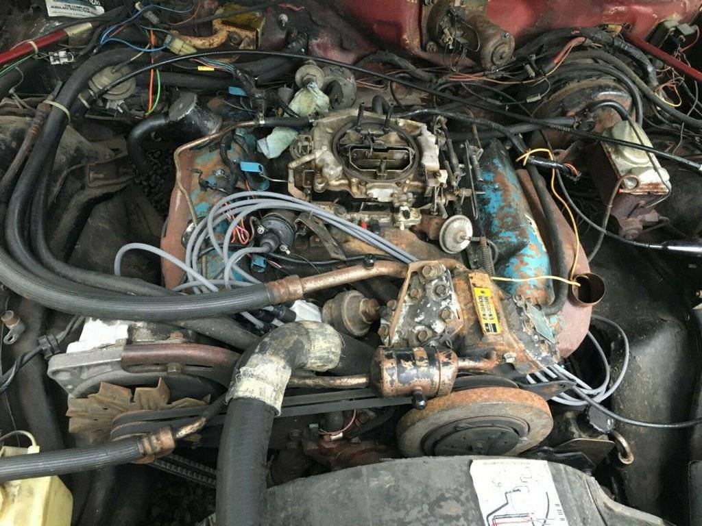

The car arrived to me running, yes. But running poorly- raw gas being dumped in the manifold and missing a cylinder. Voltage regulator and oil pressure switch wiring found disconnected. This was originally a LeanBurn car, but someone installed a 383 points distributor and ’76 version non-LeanBurn Thermoquad to attempt a conversion. I pressure washed the engine and tranny to see what I may see. Then I removed all of the hacked LeanBurn wiring, the 383 points distributor, the remaining EGR components, CB radio and alarm system abandoned wiring. The TQ carb (found 1/4” of gelatinous sludge inside) was rebuilt. A Cardone ’76 electronic Non-LeanBurn distributor was installed (A gamble, I know- read on…). I assembled a new OEM style electronic ignition system using harness connectors and hardware from my spares. All of the vacuum lines were restored for the Evap system, PCV, heated air cleaner, and AutoTemp. The missing vacuum reservoir for the AutoTemp was replaced with a boneyard Ford version (Sorry- but have you seen the silly prices these things command on the net?).

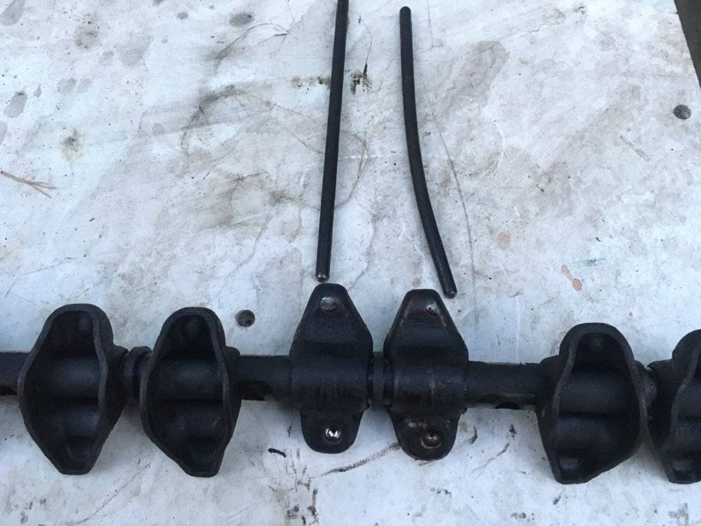

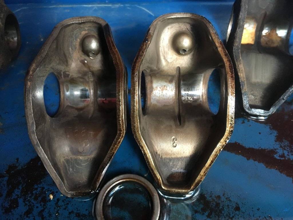

While I’m waiting for the dizzy, I decided to investigate the dead cylinder (#5 revealed when I changed plugs). Previous owner stated he received the car with a sticky lifter, and changed the oil a couple of times to attempt to get it working. With a new lifter in hand, I pulled the rocker cover, and found a bent intake pushrod on cyl #5! Now I am nervous. My experience is bent rods are usually from another mechanical failure or the engine being hydrolocked. I found posts about gas varnish on the valve stems causing this. This is new to me and interesting… I test all the valves on this side, and they all move freely! (Even #5 intake after a squirt of WD40 to soften the sticky oil on the stem.) Still planning to replace the lifter, I proceed to clean the rockers and shaft- and find two left rockers on #5! The rod must have left its rocker socket due to misalignment, and then hammered the underside of the rocker to get bent
Checked the other head to see if I would find two right rockers, but all were proper sets of left and right. Pulled the rocker shaft so I could clean it, and found the shaft installed upside down! (oil holes pointed towards valley instead of towards the valves). Reached into my parts motor to pull a pair of rockers off. Further inspection reveals the rocker shaft to be bent, thus the whole set of rockers and shaft were substituted from the parts motor.

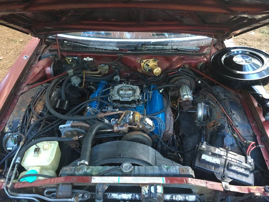

Got the motor back together again and cranked- Fired right up! A little lopey for a minute (probably while the previously dead cylinder burned in). Set idle, mixture, and advance. The engine settled into a smooth idle. The alternator is charging. After a good warmup, a short drive around the property seems to indicate a good running motor and transmission!

This engine has been apart before (besides the rocker snafu, I found RTV around a couple of the head bolts. WTH?)
The dead cylinder had been so for a long time ( heavy varnish found at the rocker rod socket and valve tip.
