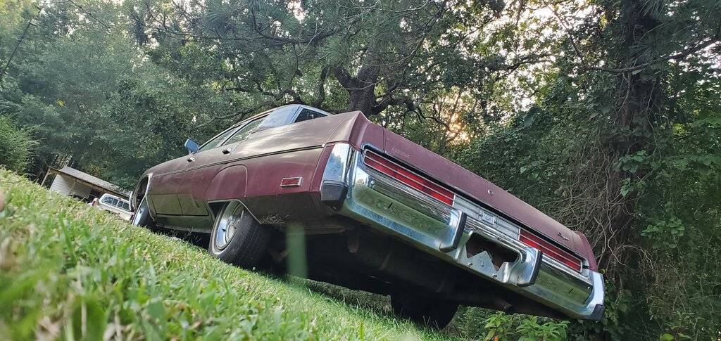

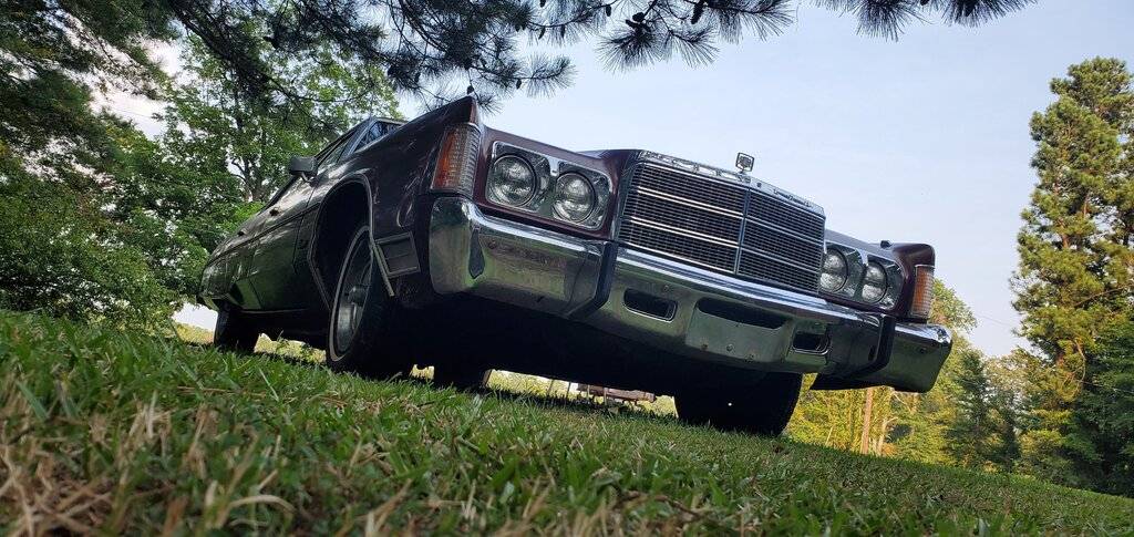

Figured I'd hop on this forum topic here. This is my 77 newport, 400, 727, ac, am/fm, tilt/tele, reclining seat, rear defroster, "road wheels". 4 dr sedan body in custom trim, with the "road trip" package. Never heard of it, but this is a unit of a road trip car!

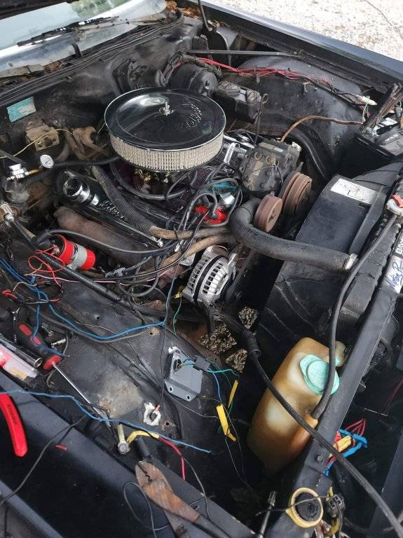

I think I got the car a month ago now. 1200 bucks, and 9 bucks in part got me a running car. Bad condenser but the guy couldn't figure out all the issues with the car.
So far I've found about 18,000 wires, and I don't think a single one was connected to anything in any way, if I recall correctly.
She did run on the gas that was put in it in 2008, so thats a plus. Then again I poured 8 gallons of new gas over the old, with a bottle of seafoam, a bottle of Lucas, and 2 bottles of heet and 2 bottles of octane booster.
Maybe I should start making my own fuel formula, and selling it as "old starting fuel" for $15 a gallon. Because boy was this a concoction.
But she ran well, cleaned up nice, I changed on the oil with 15W-40 diesel oil and a napa filter, and then again with 5W-30 pennzoil, and a Purolator oil filter. Been running dexron VI in the tyranny. So far not a problem.
I drove it today, after fixing my ignition issues. The car is beautiful, just gorgeous. Rides smooth too! I dod re key the front bars, that helped the alignment a bit and it set the car level, and it also keeps it from scraping on my driveway.
Next up I may straight pipe it just to have a little fun. Eventually when I get my street truck finished I'm going to take the engine out the car and rebuild it into a moderate performance engine. Probably put a different gear in it. Also a 4 speed swap was in mind. But that may be a project for a different day, or a different car. I may just slap a OD unit to the tailshaft of the car and call it good.
It does spin both tires. On gravel. With a miracle.
It couldn't pull a sailor off your sister if it was pointed downhill, but it really wasn't designed to be a racer, more so of a cruiser. So it will be treated as such. Speed limit, easy acceleration.
Oops! I gotta leave an hour before work so I can make the 10 mile commute. Boy it would be nice if it got to 60 before kingdom come!

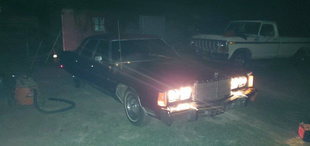

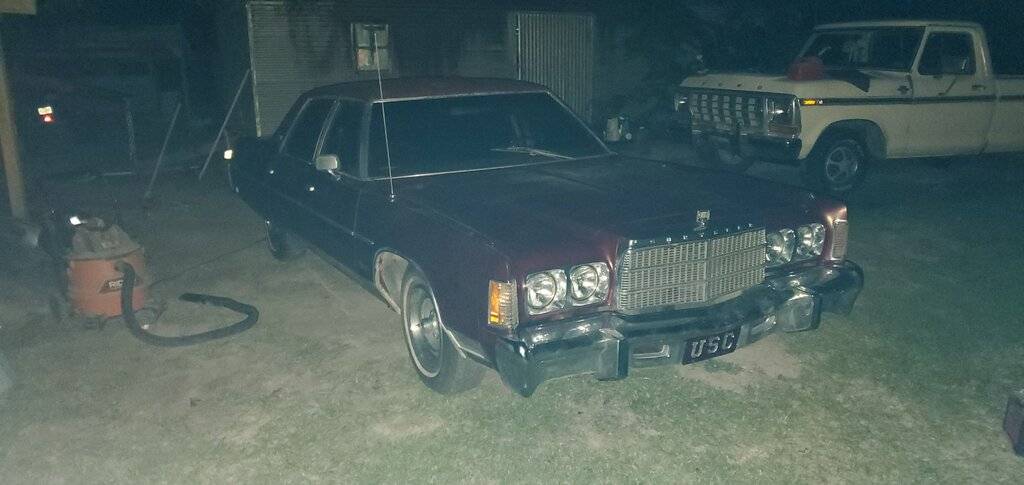

Later days... here's some pics of the car. Kinda looks like a 80's mob boss car at night. Or a villan car in some good guy bad guy movie.
Ignore the battery cables. I have the correct battery installed now, that was a battery from my truck which has the posts backwards.
Fun fact ford vehicles usually have the battery posts backwards compared to other companies cars at the time. Especially Ford trucks (mine is a 76 F100)
