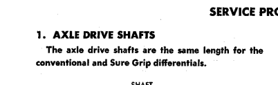

Looking at the service manual for the '64, it does state that the axle shafts are the same length between the sure-grip and non sure-grip differentials. I guess the only real way to find out for me is to stop reading and get it cracked open.
That is pretty odd. When you take the 2.76 out compare the center block to the photos in the other thread I put up and see what you have. Take a photo for us and get the date off the ring gear.
