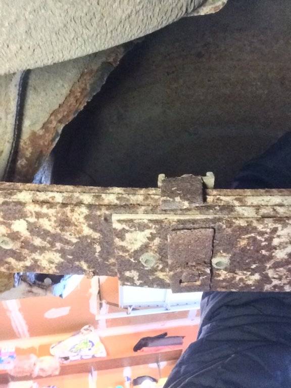

So I've got a broken leaf spring clamp...I've looked online and found some that would probably work but they aren't really the same and they don't come with the pads. Any ideas on where to get replacement clamps that are similar?

Pads? The "pads" referenced above are where the leaf spring fits in its mounting clamp to the axle. Might be better to find some in polyurethane, but they'll cost a little more.
There were two types of spring inter-leaf pads that Chrysler used. One was the wax-coated version with a plastic dowel that snapped into the spring leaf's hole at the rear of the leaf. With time and use, they'll deteriorate and need replacement. Just pry the leaves apart and install them carefully.
The other type was a zinc-coated thing spacer for the HD springs, from what I understand. Main thing was noise attenuation as the springs flexed against each other.
