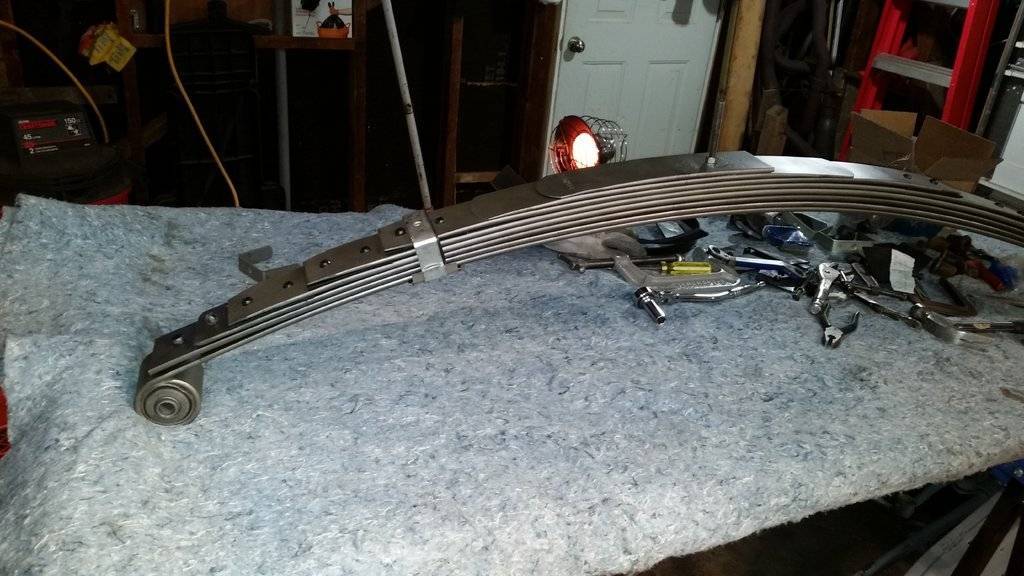

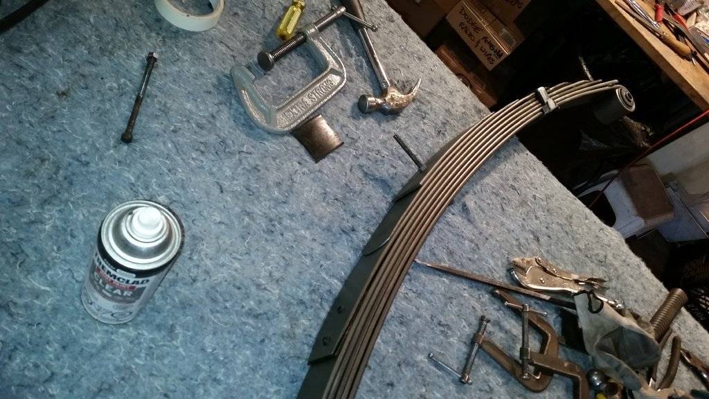

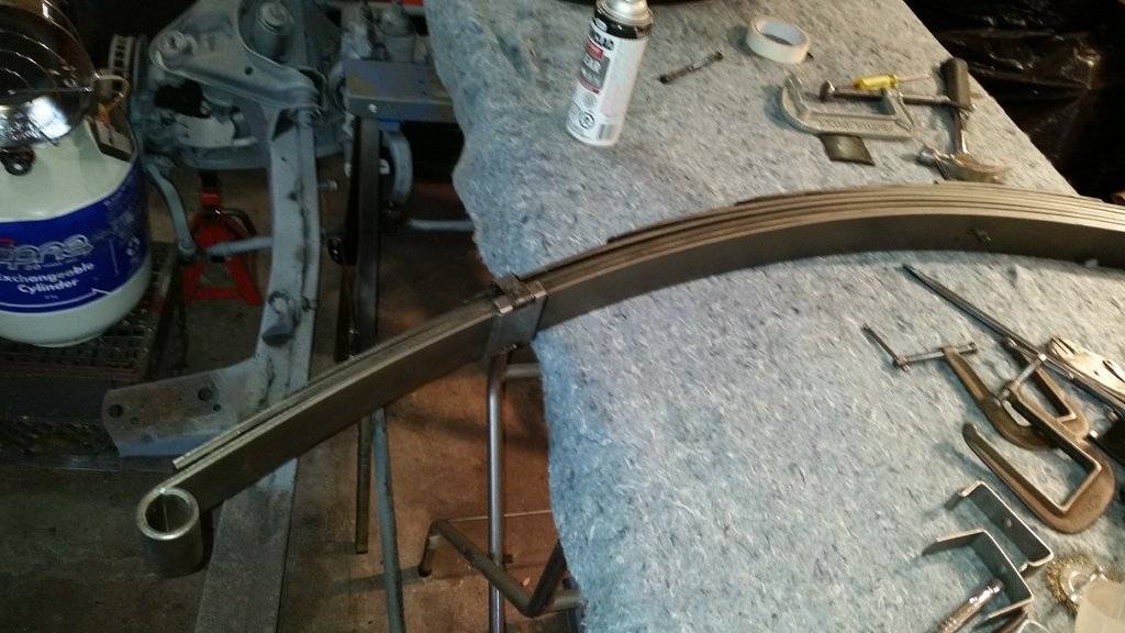

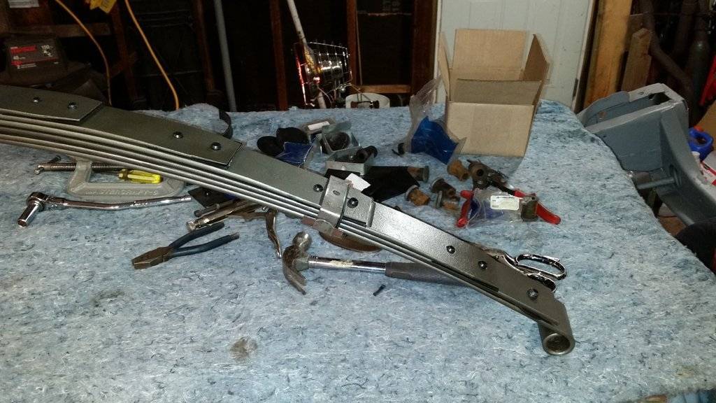

Anyhow, as mentioned in my conversation with you, if you go ahead with doing them yourself like I did, here's pictures of the finished product. You can see the clips, the rubber pads under the clips, the plastic spring tip interliners, the new spring centre bolt, new spring eye bushings, etc etc.
My springs were special order RCMP pursuit car factory cop springs with extra leaves etc etc yadda yadda
(long story), so they may look a bit different than yours, but the basics are the same.
Hope this helps.

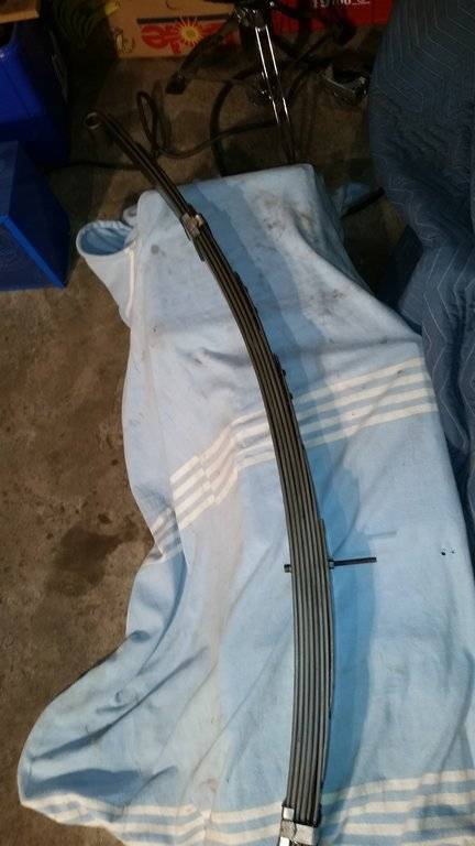

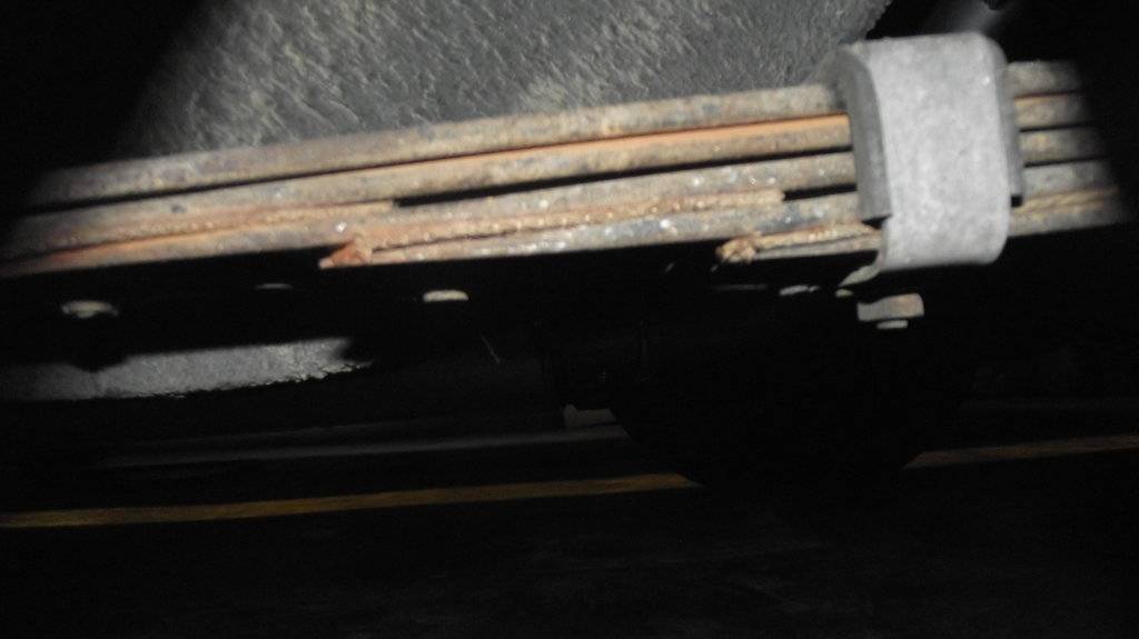

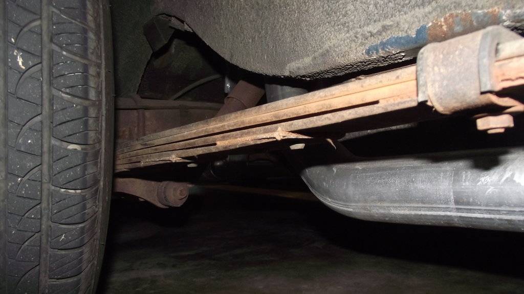

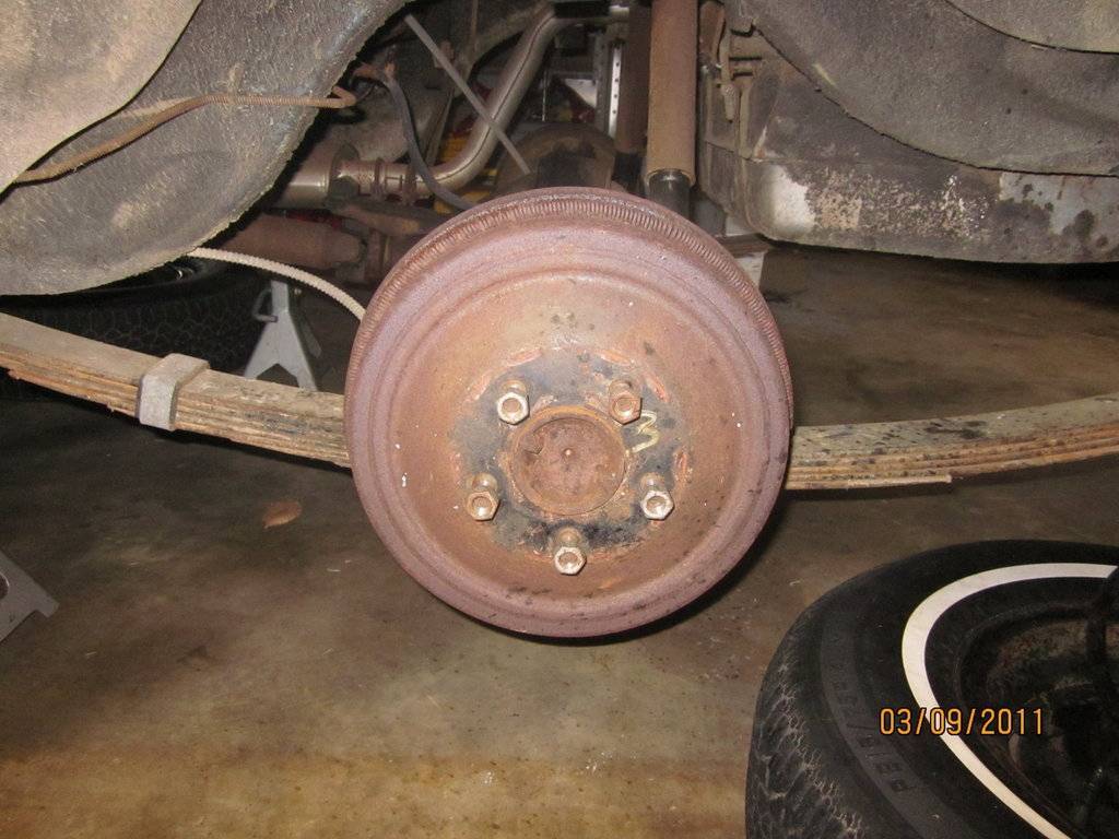

Looking for opinions now. Would you guys bother disassembling and rebuilding these spring packs or just replace the mounting bushings and maybe clean them up? The last picture is from a couple of years ago as I was getting it back on the road so things are dusty but kind of give an overall shot.
They look perfect. I'd just clean them up and replace the spring eye bushings.
I'd kill for a set of those spring pack clips.
Do NOT dissassemble them in my opinion. They are factory original and near impossible to find.
These do not need to be repaired. Replace the rubber bushings on both ends. If you still think the tail rides too low, invest in a set of rear load leveler shocks. That will raise the tail about 1" to1 1/2". If someone has rebuilt the front suspension, it might be set too high, check the FSM for the correct ride height.
Dave
Thanks guys. I'll take the advice and leave them alone. I'm having a hard time deciding what to do, and more importantly what not to do on this car.
