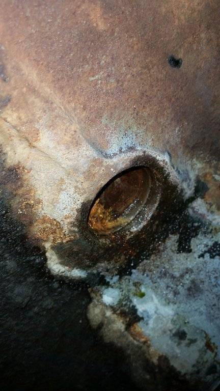

Thats why I am trying to find a replacement. I can either buy them by a specific size or I can buy a set for a 383. But I can't actually find what size that hole in the picture needs. Id like to try the Dorman that was pictured above since it looks like I dont have much room to install the "press in " kind.
I'm 99% sure it's 1 5/8" which means the part number I posted will work. Permatex #1 or #2 will work as a sealant.

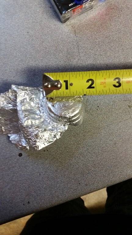

I mashed in some aluminum foil and made my best attempt at getting a rough measurement. So it looks like my 1.5" inside would agree with you, thanks!
