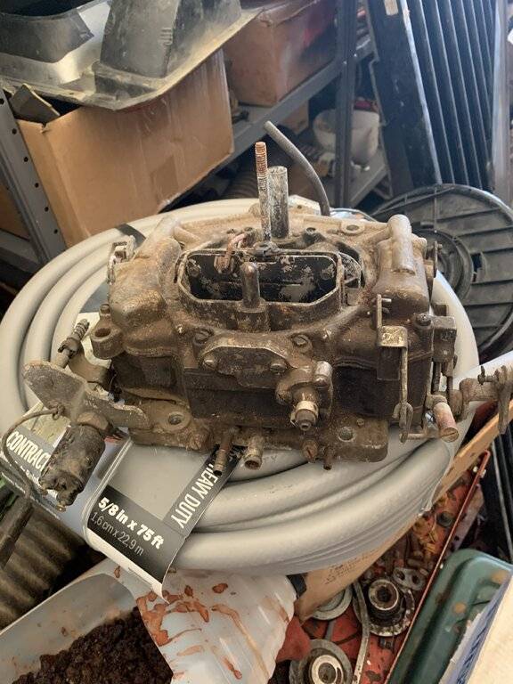

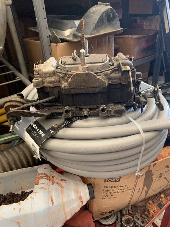

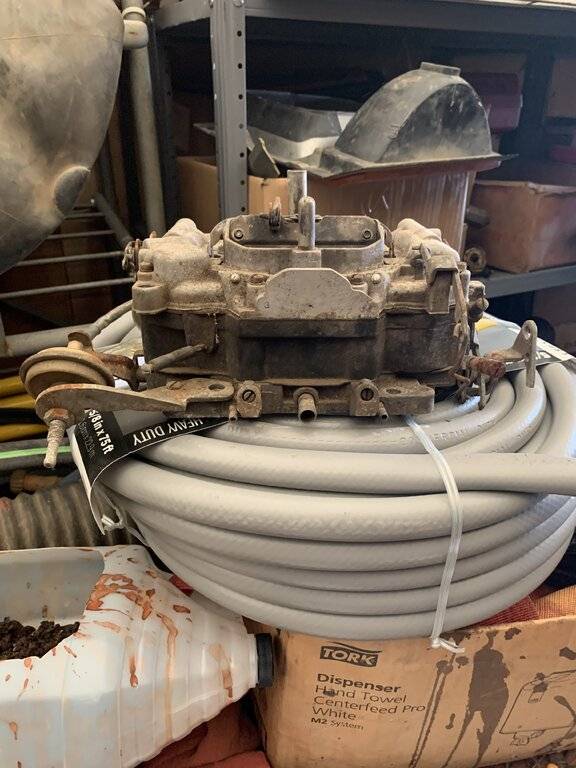

Sorry for the long wait, it has been a very busy few weeks, but here is the update.
The carb somehow fixed itself on the drive back to the hotel from the fairgrounds on Saturday evening, but in order to be safe, my dad and I sent the carb to @Dana for a rebuild.
However, I still have a question. Where is the idle adjustment screw on the Thermoquad. Most YouTube videos showed it being a silver screw being above the fast idle adjustment screw. However, I have no screw or screw hole there, so how would you adjust the idle? Is idle fully controlled by the Lean Burn Unit?
Thanks,
77newyorker440
The lean burn controls have nothing to do with the fast idle on this application. The thermostatic choke control mounted at the base of the carb on the passenger side of the carb controls the movement of the choke which in turn moves the cam that controls fast idle. A lot of these cars idled too fast because the spring in the choke control was weak/corroded from age and did not fully release the choke. A lot of techs back in the day also set up the idle too fast so that the engine would not die when the car was placed into reverse.
