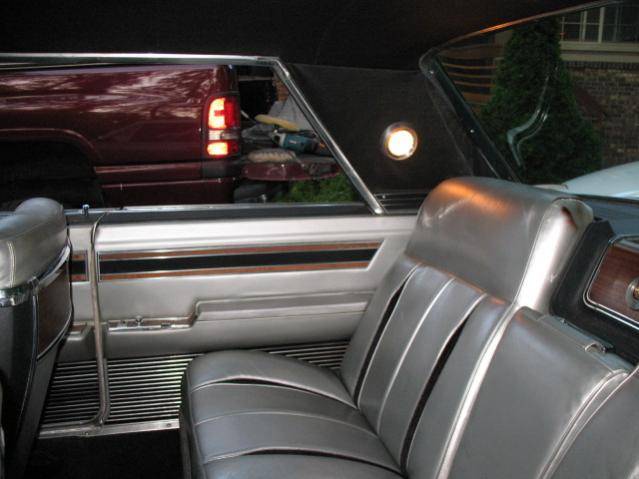

What are the best products and methods to properly and thoroughly clean and maintain and even restore leather upholstery? What products have you guys used and how would you rate their performance?
Not sure if the brown stains that I have are from the sun or if its dirt but I think it's from the sun because it's on the back and tops of the rear seat headrests and I haven't been able to clean it off so far. I may have to dye some of the bad spots back to silver, what would you guys do?
In the second pic by the headrest you can see what appears to be a burn mark and the leather is kind of crispy feeling up there.
I could tell you soap and water is the best cleaner but I have never owned leather anything. The discoloring does look like it is from the sun.
That's what I am thinking. Somebody told me of a product that sounded impressive but I had no way to write it down and don't remember the name but he talked it up like it was a miracle product.
I own a custom gun leather business. My opinion and worth every penny you paid for it is stick to the basics. Saddle Soap applied in a circular motion with a soft brissle brush and rinse with a damp towel. After it is dry and I mean completely dry gently rub in a little neatsfoot oil. The proccess should take about as long as it takes to smoke a good cigar. That is per seat, 2 cigars should have you on track.
Oh and the discolorization is from sun bleaching or burrning the color out of the dye.

It schould solve your problem if the brown discolorations are caused by 45 years old dirt...

I actually have the brown spots taken care of some time ago for the most part, now I just need to soften and condition them.
