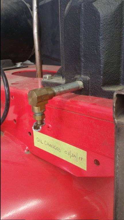

12 year old 60 gallon husky pro right next to my beer fridge. Just did an oil change on her. Mounted to a 1/2" thick powdercoated aluminum plate w craftsman tool box wheels on it. I have an oil drain petcock for the pump, and a drain standpipe with valve and hose coming out the bottom of its mounting plate to drain the tank periodically. Nice thing about this is, the water collects in the brass tube below the tank and not in the bottom of the tank. This helps prevent the tank from rusting out at the bottom, and you can aim the tube out the door and open the valve keeping the water outside. I also have a custom made hose hanger made out of 1" square tubing bolted on, and i use a 50 ft flexzilla hose which is bad ***. All works like a charm. Hope this gives y'all some ideas.
