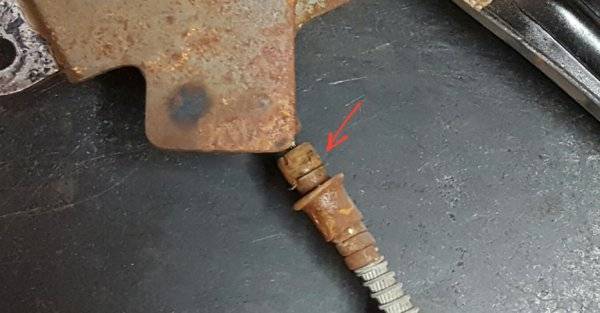

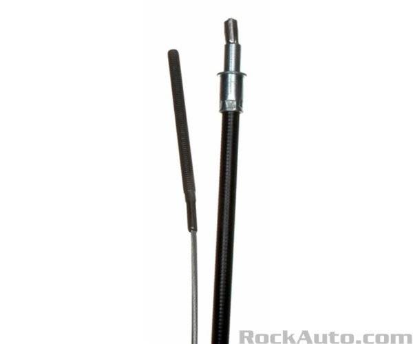

Have to replace the front parking brake (e-brake) cable and the new cable does not come with the "squeeze"-type retainer that holds the end of the e-brake in place at the pedal. Any ideas how to hold the new one in place? I've attached a couple of pics of the old-style clip and the new end without a clip
