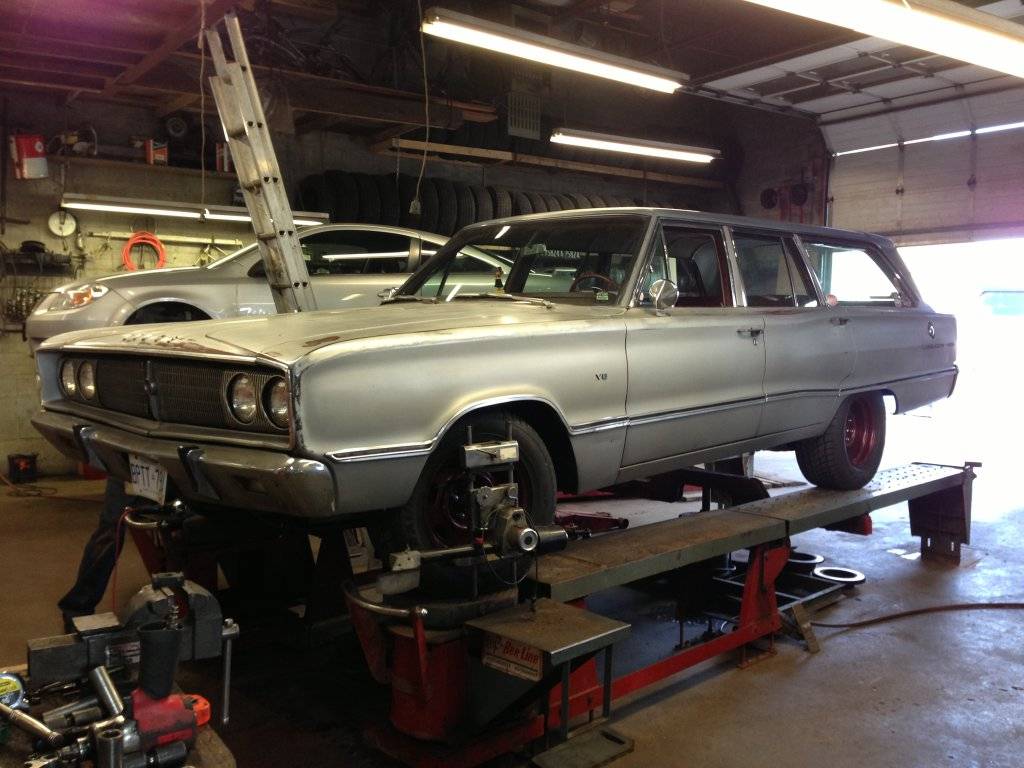

I always take some load off the front end when adjusting the bars. What can happen is not the bar breaking, but the adjuster bolt strips out. While I was having an alignment done on my wagon, the tech tried to tighten the adjuster, a loud bang and bolt shot to the floor with a tech jumping from car and cursing.
