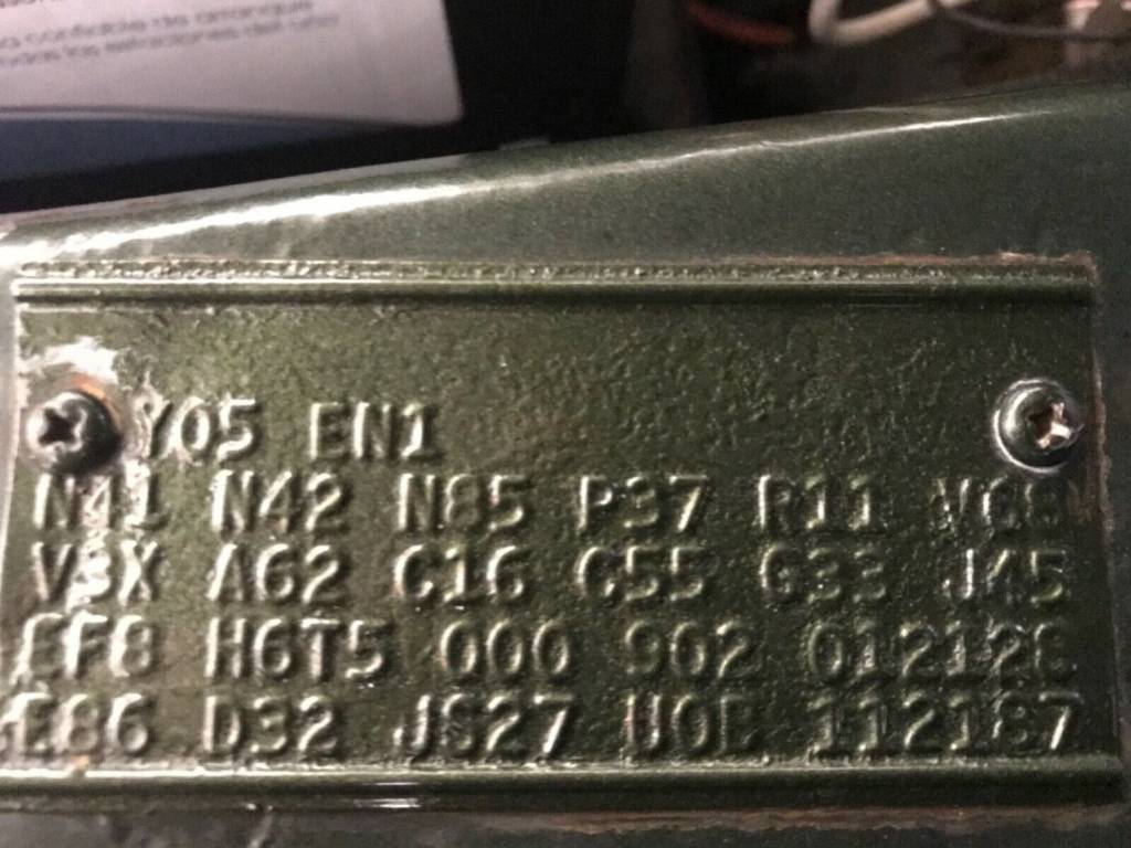

On your fender tag. See the second row from the bottom where it says "902"? That's the scheduled build day. 9 being September and 02 is the date. Yours should look the same. You may have A, B, or C instead of a number. A03 would be October 3. B is November and C is December.
