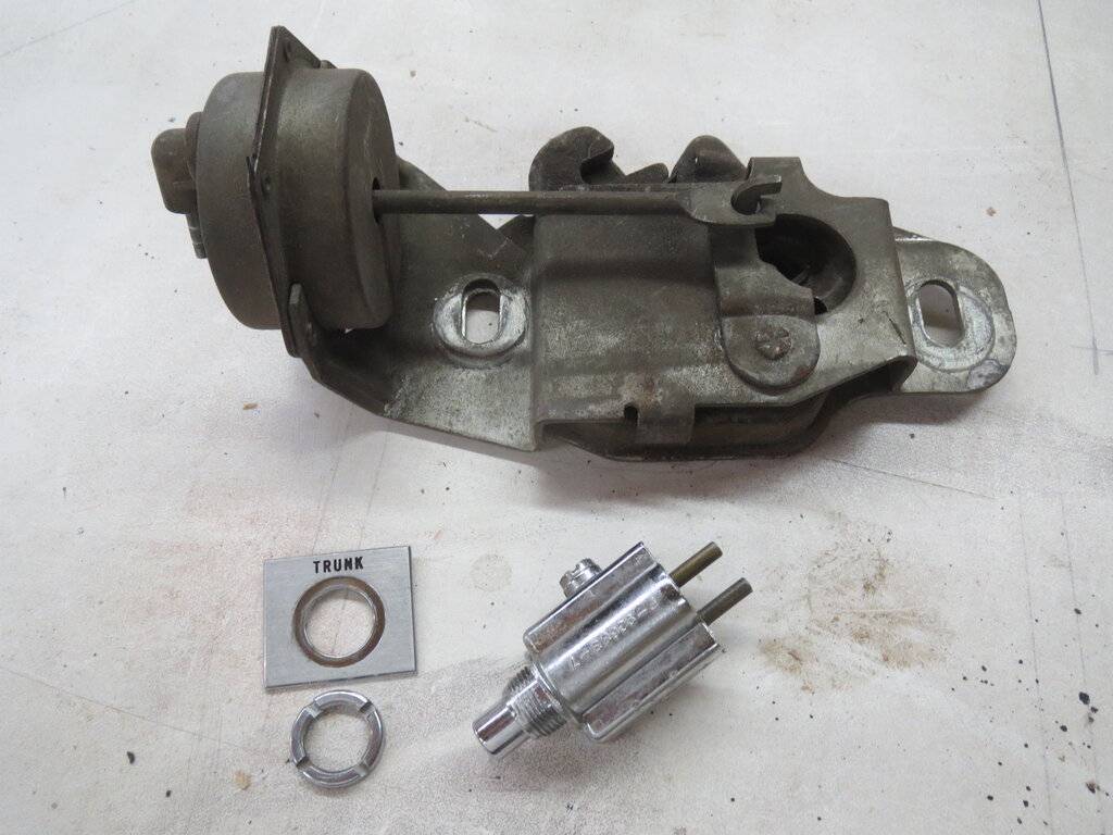

    Thanks John but I’m going factory on this one. I already put in the vacuum canister and the other pieces will install in minutes and then all I have to do is run the vacuum hose.

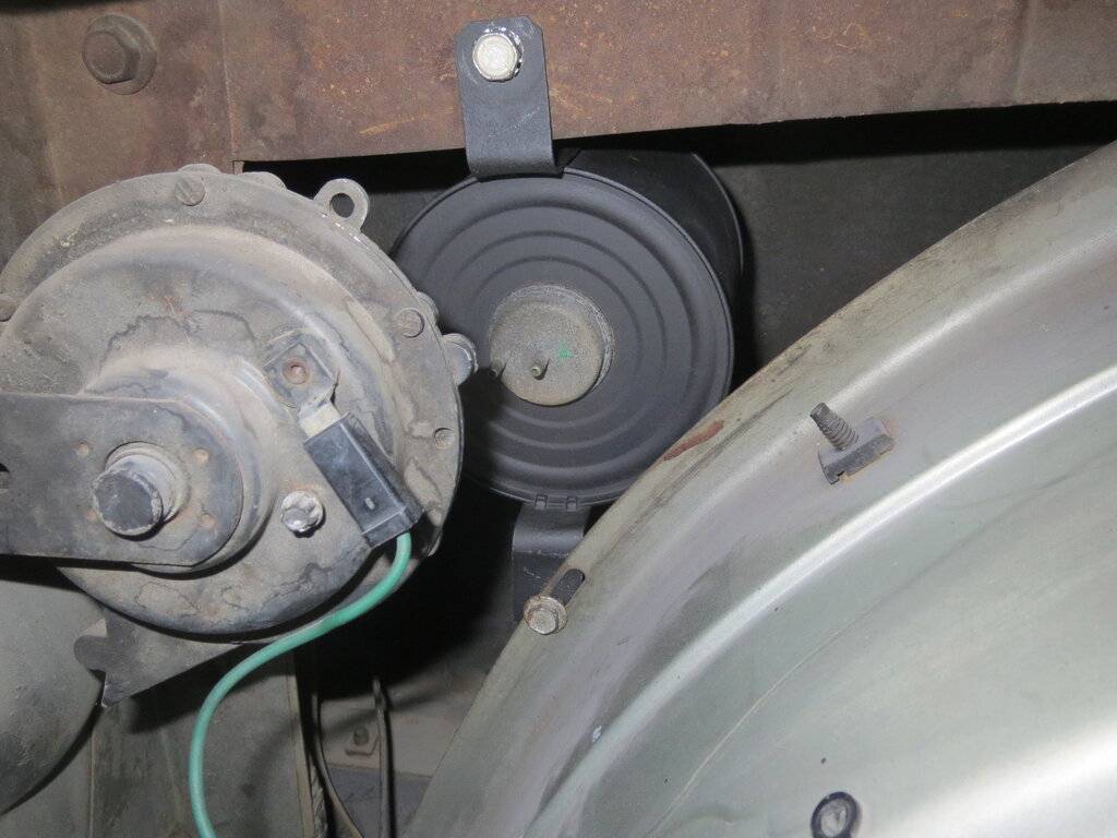

    DETMATT i put it in my road runner but have not hooked it up . crap they want alot of money per foot of vacuum hose. were did you plug in the hose on the motor to go to the canister .( pic ) if possible
    thanks

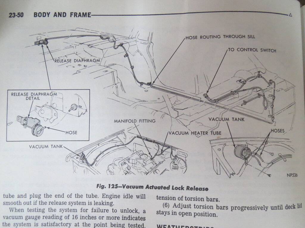

    Completely by the book!:D
