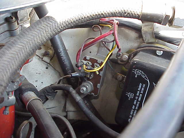

I always thought those inner cutouts were to enable better access for spark plug changes, etc.
Not sure this helps much, but here is a photo of the inner fenders on my 1960 Chrysler 300F that have never been out or altered or painted.
Thanks for that. My 60 Plymouth Sonoramic Commando has the body color inner fenders, and also has the cutouts.

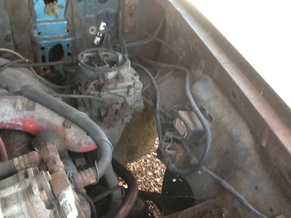

Here is a cut out pic of a 999 special order paint 61 G. It's hard to tell in pic but,is original exterior body color.

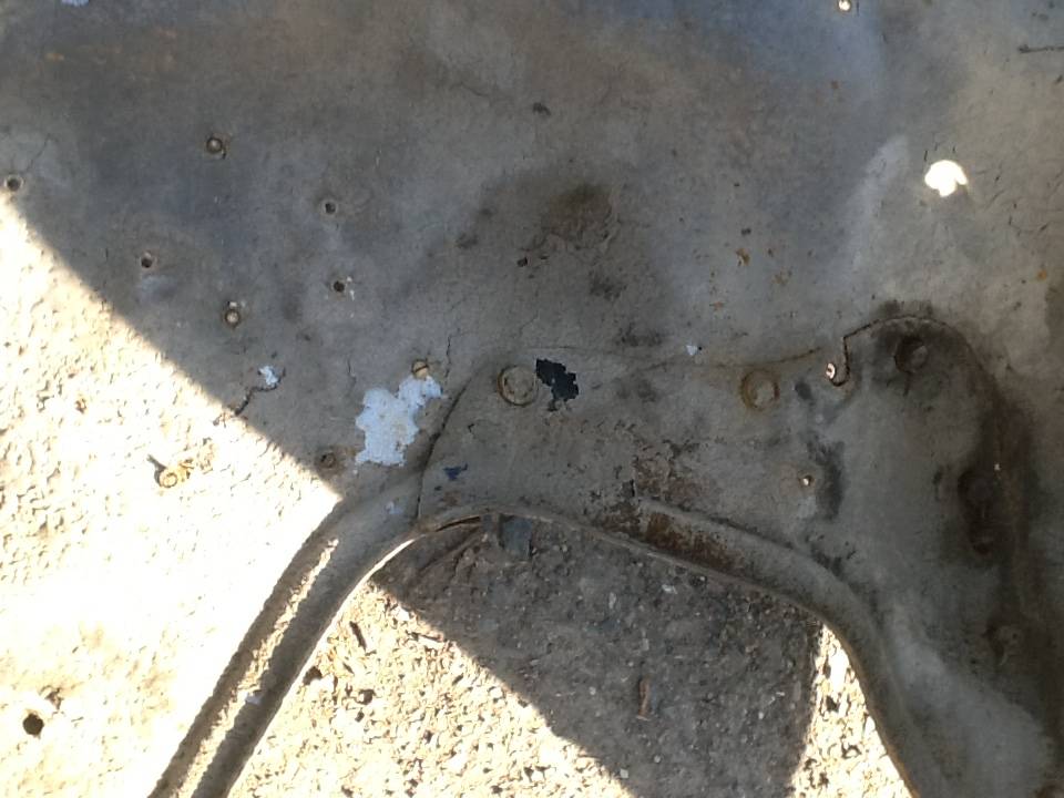

Also I dug out the 63 inner fenders that came from a white car and I was mistaken. They do appear to be originally white. The cutouts themselves appear to be black originally

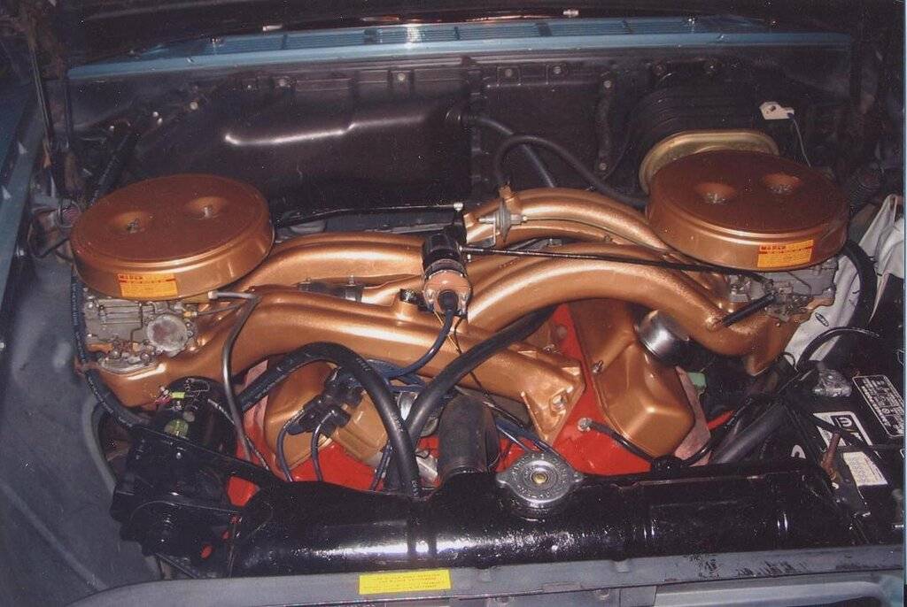

My current '60 Fury was shipped from the St. Louis plant on October 25, 1959, to Bill Goodro Chrysler-Plymouth in Denver, but wasn't sold until February 23, 1960. As you can tell from the photo, it has the all-black engine bay. It is a very early car as it has the has the ball-joint carb linkage rather than the slotted type that came later. It is an unrestored car that had only 43000 miles on its clock when I picked it up in 2000 from the heir of the original owner (who was a rancher in a high mountain valley here in Colorado who used it as his "Sunday-go-to-meetin'-car).

While I do not disagree that the access covers help spark plug servicing and such, I do feel that the assembly line procedure had a factor. The engines were assembled when the body drop was done, and therefore on cars built with the body color inner aprons, it is impossible to drop the body down over the ram tubes without the access holes. Without trying to be repetitive, my question regarding these panels, is about cars with the black inner fenders. Do any cars with black inner fenders have the access panels?
Because I do not see why they would.
If your car has the black inner fenders, and no access panels, that supports my theory.
