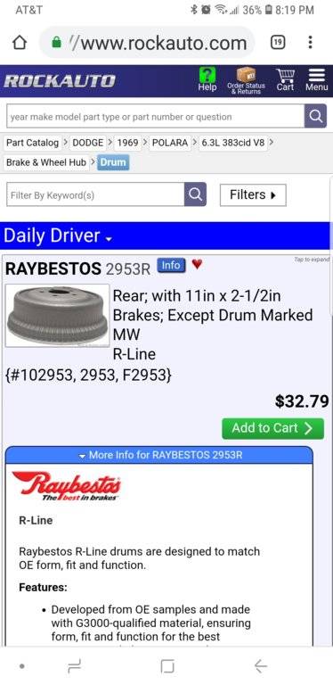

While refreshing my rear drums, I realized that I had ordered the wrong size drum! Does anyone know where I can find 11x2.5 inch drums at a reasonable cost? These are going on my 66 Fury. Cheaper the better for my budget.

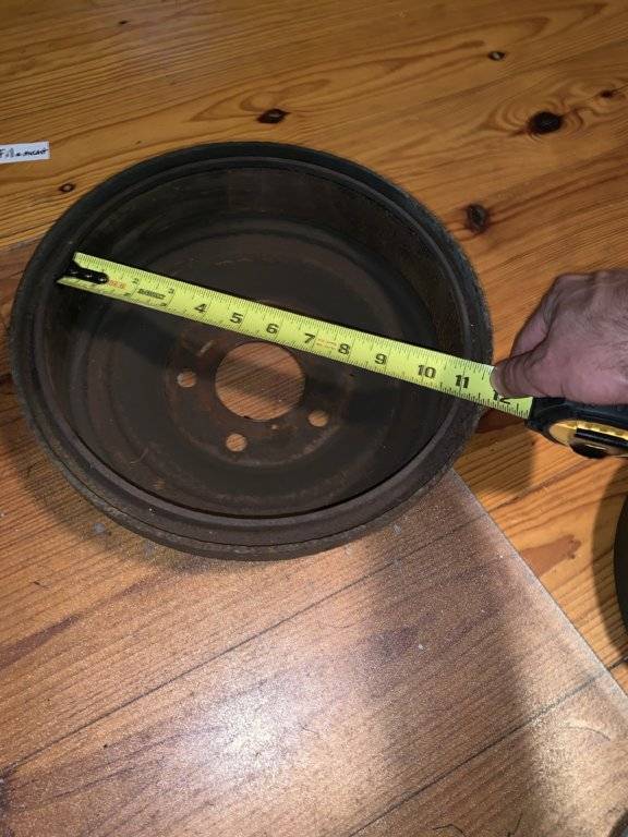

Incidentally, looking at your ruler -- those don't look to be 11" x 2 1/2" ------ they look like the light duty brake system ------ with the 11" x 2" Rears --- you had better measure the brake shoes width --- and that is probably 2"...... Whole different situation....
Remember, the brake shoes does not go lip to lip -+
Such that an 11" x 2" drum is roughly 2 1/4" deep
Whereas
An 11" x 2 1/2" drum is roughly 2 3/4" deep.....

Although to be fair, I think he is correct. The shoes are only 2" across.
