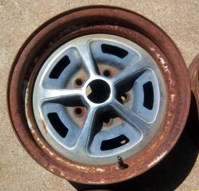

Looking for advice + id these rims
MoPar~Man
Aug 21, 2022
824
446
Ontario, Canada
When it comes to wheels I have zero knowledge or familiarity with anything that isin't a plain steel wheel.
I'm told that these are 14" x 5.5. What are they, and would they have been a factory or dealer option for a '67 Monaco?
I can't use anything with more than I think 4.5" backspace / offset. Where are the holes for the lugs? Do those covers come off? Can I put my regular hubcaps on those?
Also, what would be a "good' price for that set?

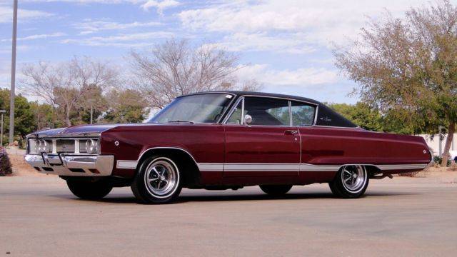

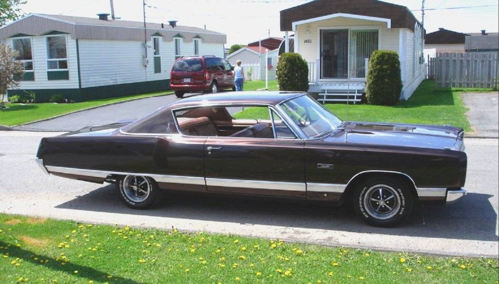

There's a '67 Coronet for sale on Haggerty with these wheels:
Seems to be the same type of rim? Were these 1967 only? If this was available on a Coronet would they also have been available on a Monaco / Polara?

Those are Magnum 500 wheels, of course.

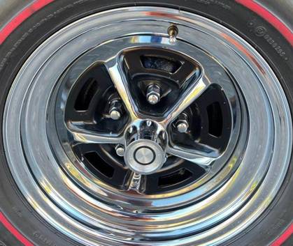

Being completely chrome distinguishes them from the mid-70s versions, which were more silver-colored and/or without a chromed rim - the later ones used a brushed trimring instead. (pic below)
There is a subtle but distinct difference when you know what to recognize.
I cannot speak to the question on the covers on the lugnut holes - the picture doesn't have enough resolution.
Those should have a lot less backspace than 4.5", they should be 3.75" or so.

I'm told the Magnums (the rims in question, see photo in first post) came off a '72 Challenger.

There were only two sizes of 14" Magnum 500s, 14x5.5 and 14x6.0. Whether Ford or Chrysler (which have the same 4.50" bolt circle).
Probably more B-bodies came with the Magnum 500s than C-bodies, I suspect. You can check the Chrysler parts book to see where the 14x6s were used on Chrysler products.
Ford used the 15x7 Magnum 500s on many higher-horsepower Mustangs, with 4.25" backspacing. Chrysler NEVER did use that size on anything, from the factory, circa late 1960s into the earlier 1970s, generally. Although those 15x7 Magnum 500s sure do look good on the '68-'70 Chargers, they are really Ford-spec repro Magnum 500s. But the 14x6 Magnum 500s also look good on the B-body Chrysler products, too.
On your wheels, the "JK" stamping designates the style and height of the bead area of the wheel. Significant for wheel history, but as all wheels were of that bead configuration by that point in time, not a big deal for anything, other than being what it is.

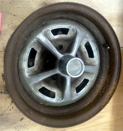

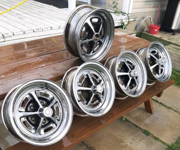

When I see these rims for sale in this condition (For $350 for set of 4 first pic):

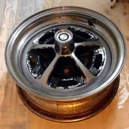

And yet I see others with no rust on the outer part I'm wondering why did these rust so bad in that area? Was it not chromed or was it painted or what? How do you sand blast that to clean it up without messing up the center part? Compare the center cover in the second pic with the rims in the photo of the first post.
Or should I just give up trying to ID these rims to figure out their exact original source because there were far too many of these made with various different constructions?
Would an actual "magnum 500" rim sold on a dodge or plymouth have had a different center cap (with logo?) or just the generic circle that I see on a lot of these? (I don't even see anything in the second pic, is it missing something?)
I understand that some of the early mag wheels had the center mounting plate rivited (not welded) to the wheel? Wouldn't that be a source of air leaks (and questionable long-term durability / strength) ?
No logos on the center caps, for any OEM Magnum 500 wheel. The ones sold by Motor Wheel, it seems, had a crossed-flag image in the middle of the center cap. There WAS an image in the recessed portion of the center cap . . . a thin circle with a few thicker segments on it, as I recall. Maybe some stick-on center emblems in the repro world?
The later model Magnum 500s only had chromed centers, not the outer rims. The paint was mainly to prevent rust in the earlier years of the wheels' life. It was covered by a trim ring on the later versions.
AMC had some Magnum 500s as OEM options in the earlier 1970s. Centers were painted, not chromed, and the outer parts of the rim were black-painted, with a center cap like the Chrysler wheels, but probably NOT exactly the same. Maybe a hair taller?

I have the wheels now. 5 rims, 4 with center caps. $250 Canadian (that's about $190 US). The guy I got them from is restoring a '68 Satellite (and they're making full trunk floor pans and interior floor pans for them!).
From what I understand, pre '69 wheels were chrome plated (rim and center). But '69 and later (how much later?) the center part (and maybe the rim also?) was stainless and had trim rings (because the rim was painted black?). So if they were really stainless, I would expect that (a) a magnet would indicate that, and (b) there'd be no rust on the backside. But all the ones I see for sale the backside is pretty rusty.
For mine, a magnet tells me that no part of these are stainless (but the center cap is only weakly attracted so maybe that's pot metal?).
Is there a way to read a date code on these? I'm thinking these are not really pre-69 but a reproduction (maybe 1980's or 90's?)
The center caps seem taller than they need to be to cover the front wheel hubs.
What's the best way to clean up in between the spokes to prep for new black paint?
