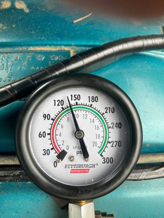

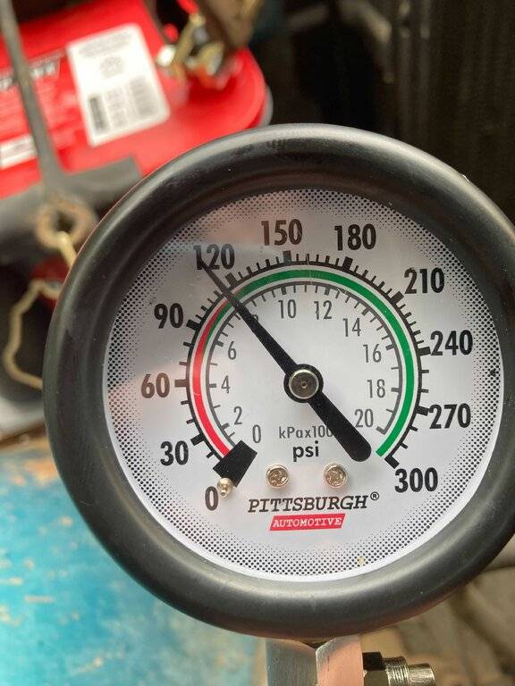

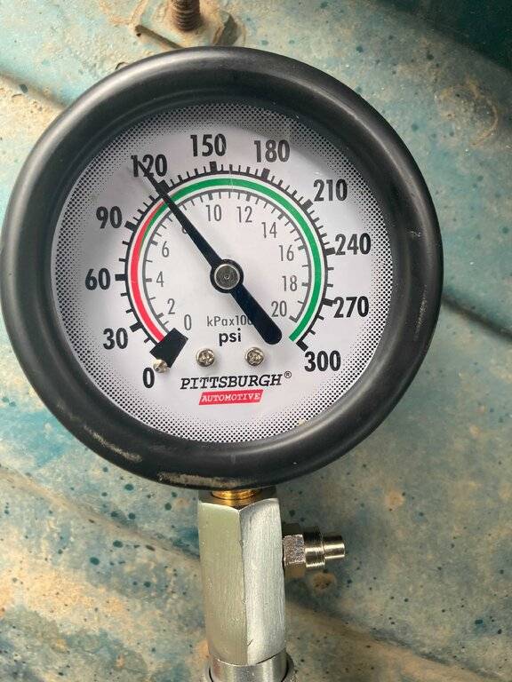

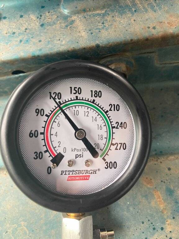

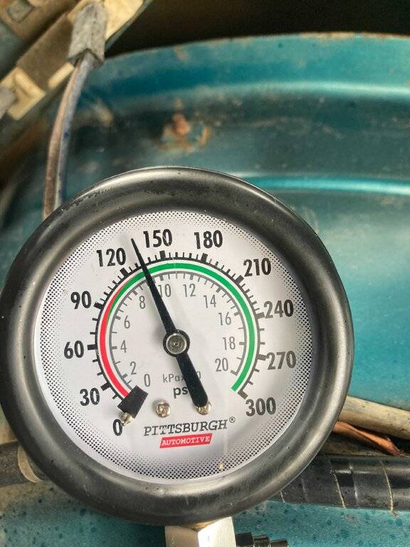

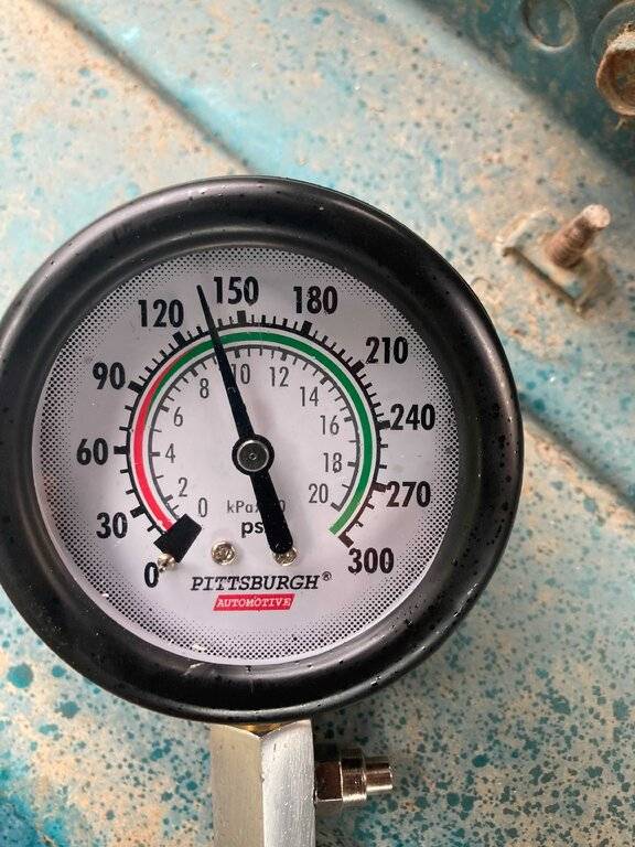

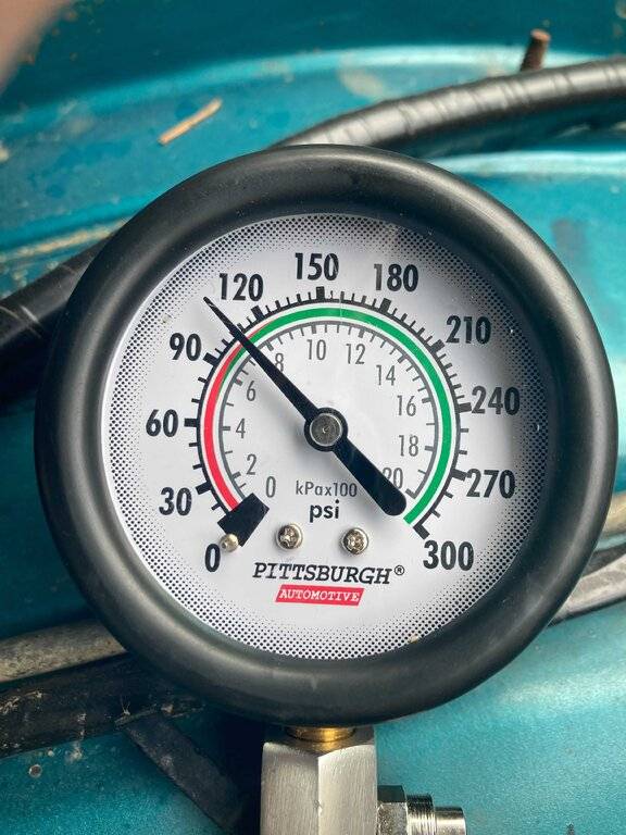

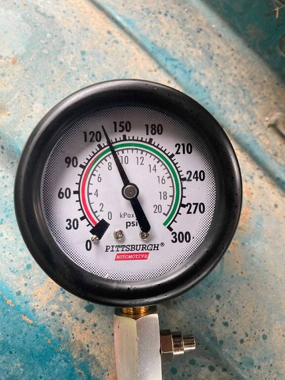

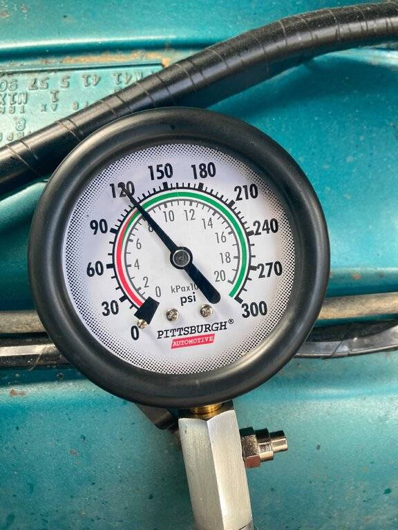

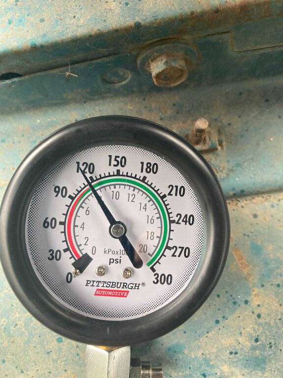

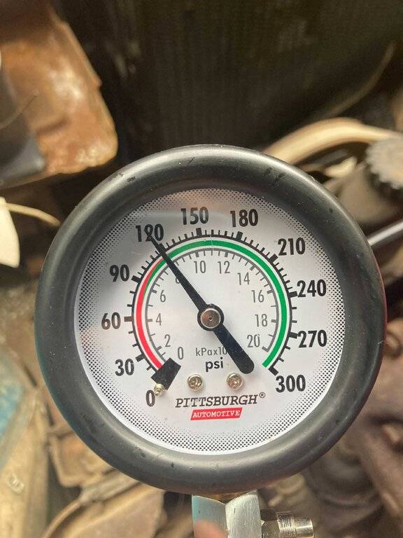

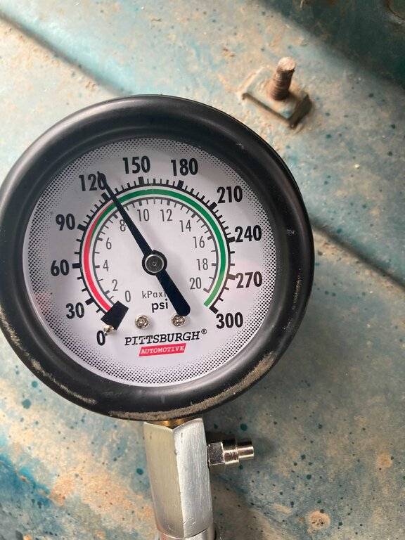

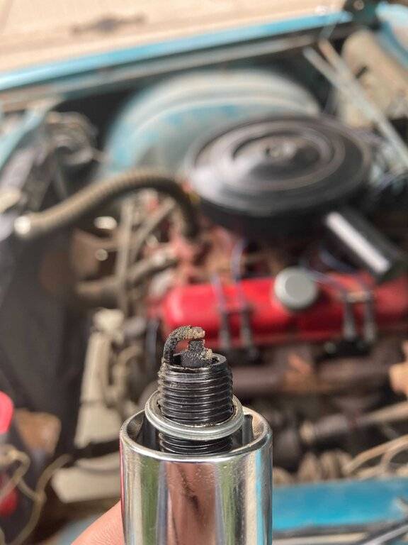

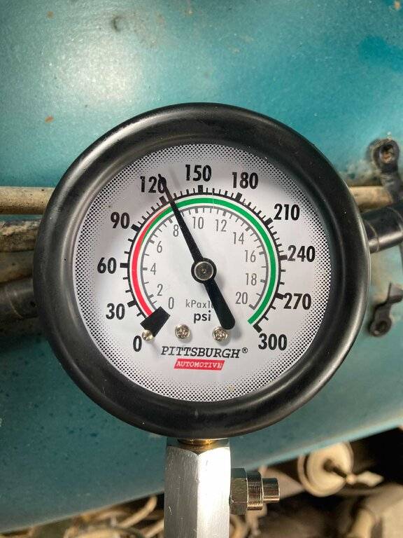

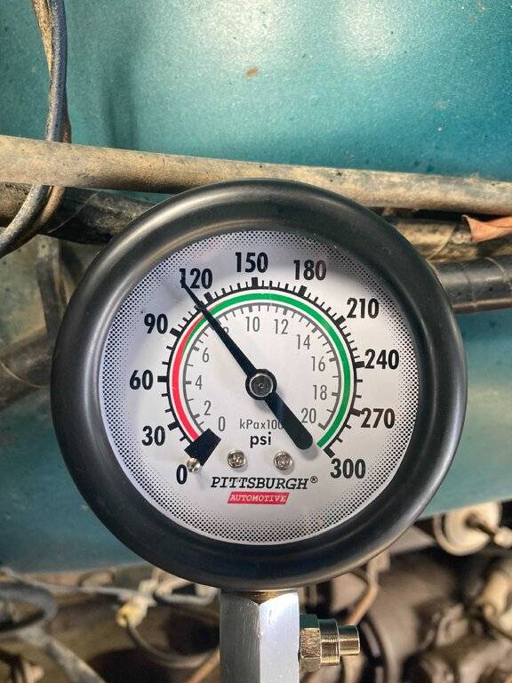

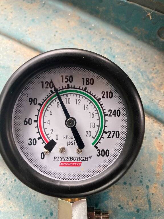

UPDATE 2
Finally got a chance to grab a compression tester from my buddy and get to it today.
I'll drop photos below, but all cylinders were within 10-15 psi. Numbers ranged from 110-125 on the "dry" test. "Wet" test ranged from 115-130, averaging a ~5 psi increase on each cylinder.
The plugs were noticeably dirty, with only 1 looking not too bad. Its a wonder it ran as well as it did with these things. Ended up driving to Autozone to get some new plugs, didn't feel right putting these back into the engine knowing little bits were falling off.
After replacing the plugs and hooking everything back up, she fired up a bit smokey from the wet test but then smoothed out to a nicer idle than I've ever heard it have. Hardly any shakey-ness at all now as well. Did a few laps around the neighborhood and it's hardly putting out any smoke...or at least an acceptable amount. My neighbors must have loved me today cruising around with no muffler!
I also just received some near mint hub caps from member Mike Parker and man are they beautiful. The challenge is now to make the rest of the car match!
