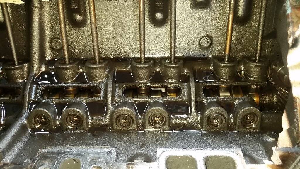

Also, while I already have everything apart, what parts should be checked for wear? The bottoms of the lifters are slightly pitted from the car sitting for 20+ years, and I plan on replacing them.

As noted, the screw is not likely to have gotten into the engine unless it fell into an intake port. If the engine is knocking, it is probably some other cause. Remove the oil filter and pour the contents on a dark rag to check for metal. If the filter is full of metal shavings, most likely a bearing has failed and you are headed for a rebuild. If the filter is clean, rent or borrow a bore scope and start checking the cylinders for piston damage. Your cam does not appear to show any abnormal wear, do not need to replace it unless the engine needs an overhaul.

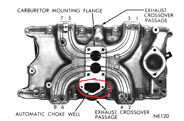

That's the choke well. No way for the screw to get into the combustion chamber/valves from there. The exhaust crossover is also not an access point. That's a LA small block intake in your post, not a B engine intake.
That’s what I was thinking, no way unless you dropped it down the carb.
In '72, as I recall, there is a stainless steel cup into which the choke thermostat resides in. Remove that cup and gasket, and all that's underneath is the exhauast crossover passage between the heads The exhaust gas pulsations could easily cause that screw to travel between several exhaust ports before it finally stopped somewhere. Why was that stainless steel cup absent from the manifold? Just curious, but doesn't really matter now.

I had the choke off because it wasn't doing anything and making the car very hard to start at times. One of the small bolt heads broke when taking it off. When I went to put it back on, I dropped one of the new bolts down the choke well. If it doesn't lead to the valves, where does it lead to? I've tried to find the answer in the FSM. I've shined a flashlight into the hole, but it bends so sharply that I can't tell where it goes.

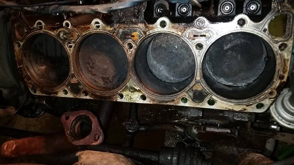

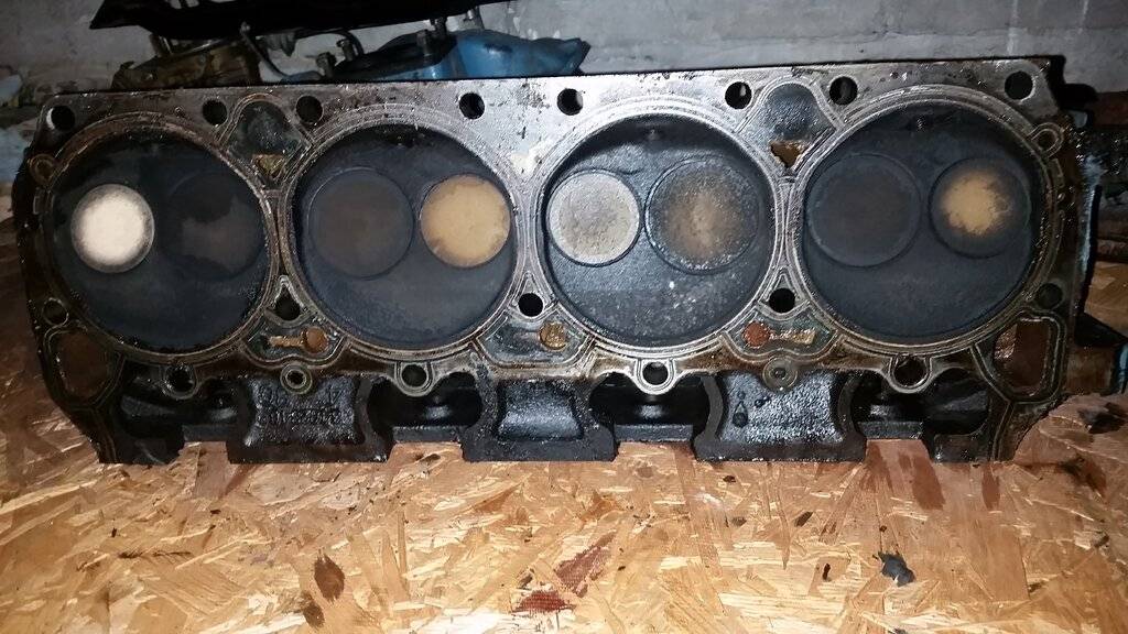

Finally got the head off. What a pain. So much headache could've been saved by running a magnet down the hole...

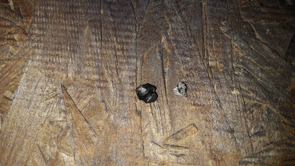

The top of the piston, and the valves have a visible "hammered finish." It is the screw, I can see part of the threads. It bounced around and eventually lodged its self in the top of the piston. There is faint scoring on the cylinder wall.
What do you all advise that I do?
Doesn’t look that bad. How deep is the scoring on the cylinder wall? No holes in the piston?
The deepest score line I can just barely catch with my finger nail. The next deepest I cannot. The chunks are the remains of the screw.
As far as I can tell there are no holes in the piston. The deepest pit is around 1/16 of an inch. I don't know how thick the pistons are.
I believe the knocking was caused by the lodged screw making the piston contact with the top of the cylinder head. If it continues after its all back together, ill check the rod bearing.
In no particular order: The head should be disassembled and the valve and seat checked for defects, the valve could be bent and the seat could be damaged from things bouncing around in there. The piston needs to have the top cleaned and be checked for cracks. It is also advisable to remove that piston and check the body for cracks and the rod for misalignment. There appears to be two small cracks or gouges in the piston head. The head should also be buffed to remove any sharp edges so that there will not be a hot spot on the head that would cause pre-ignition. The scoring on the block does not look that bad.
