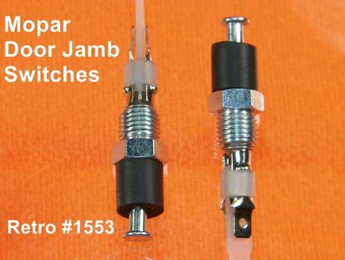

As Stan said they are in the forward portion of the door jamb, you can access the wire from the rear if you remove the kick panel, they often succumb to moisture and dampness and are available reproduction.

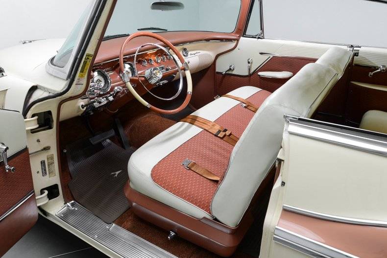

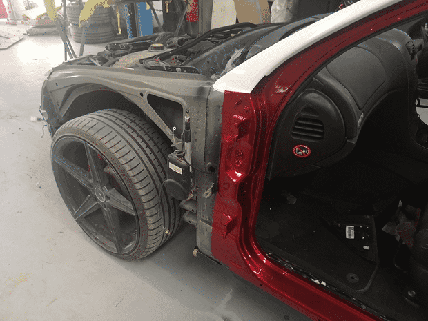

The front door jamb which is part of the cowl is where you'll find the dome light switch. Here is a picture of a door jamb and cowl area with no door.
In the photo below, you can see the hinges, and the door light switch poking out below the upper hinge in the front door jamb.
