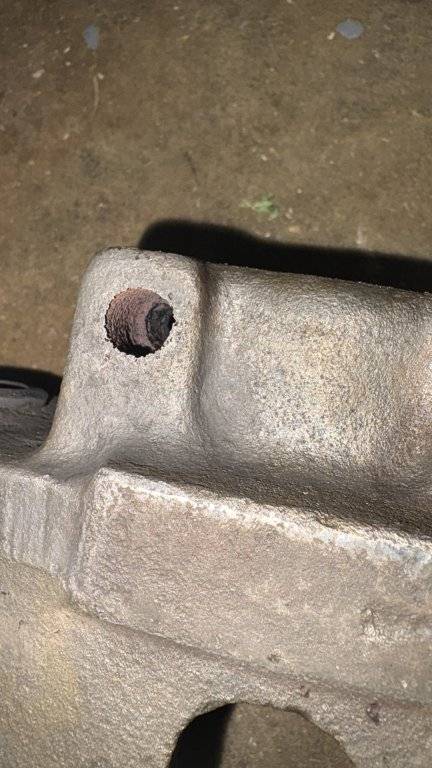

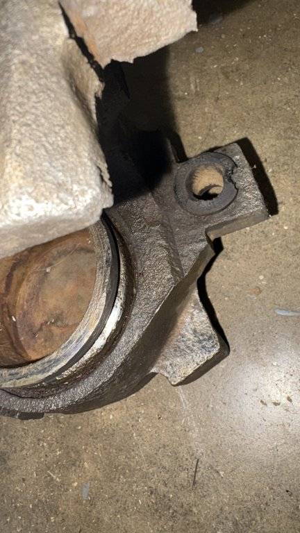

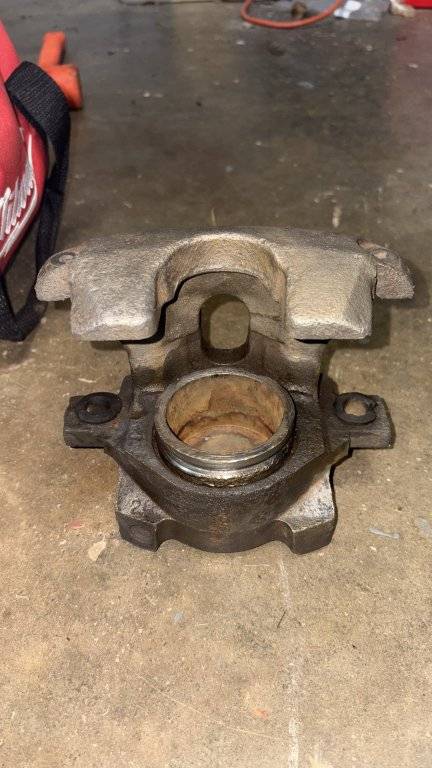

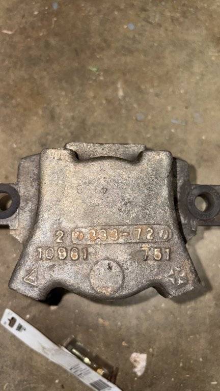

As title says. Any C body 1969-1973 should have the front driver side caliper I need. Mine was seized, and I soaked both sides in vinegar to loosen them. One of them came out clean and I was able to force the old piston out and rebuild it. The other- I haven’t had good luck with. The bleeder screw hole is now much larger for some reason after soaking and I’m unsure if it’s even worth saving with it still being stuck.
Here’s some photos for reference of my car (1973 Chrysler Newport) and what I’m looking for. Thank you for your time.

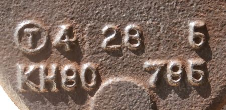

I've been dismantling my '73 Satellite, I took the calipers off, I wonder if they'll be similar to what the OP is looking for. I'll take a pic.

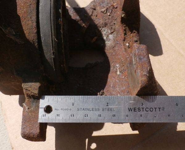

That B-body caliper is probably too narrow for the C-body. We've had a few go through this before and it's a 1/4" difference.
Calipers and disc brake problem-ID needed
Ah yes. 2.75 inches for the B-body caliper:
